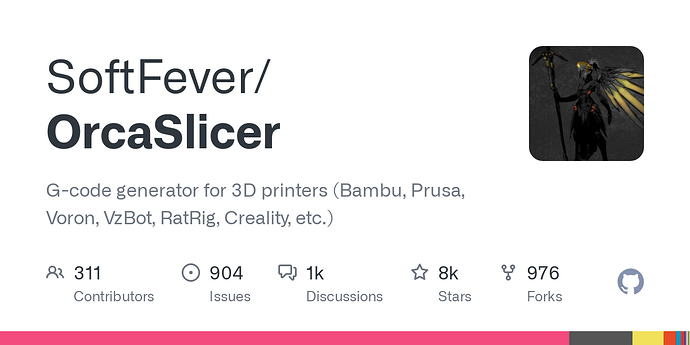

Switching to Orca will not help if you allow the updates as it will be blocked. However, it has many features BL doesn’t, just like Bambu Studio has code Orca doesn’t. Many people here will tell you it is a solid option to Bambu Studio. It’s free, so download it and give it a try. You can always do a post asking for people’s opinion on Orca.
Just be sure to get it from the GitHub and not OrcaSlicer dot net
