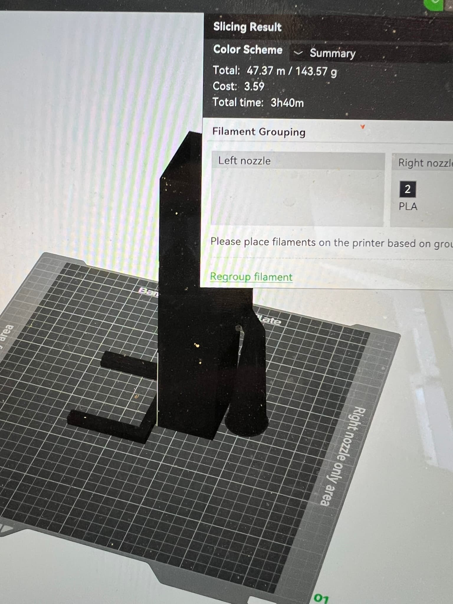

exact same settings on H2D and X1C for a project with one color and two objects
X1C printing time 3 hrs 19 minutes
H2D printing time 3 hrs 40 minutes
So the H2D is 21 minutes slower?
Who has the same experience?
Everybody has the same experience, it’s like expecting a top of the line excavator to be faster than a Fiat Abarth.
The H2D is a multi tool and the X1C is built for speed
The only real difference is the two nozzle configuration. And that is causing more problems than on the X1C when using multicolors. the H2D has a more unfriendly GUI regarding printing multcolors.
