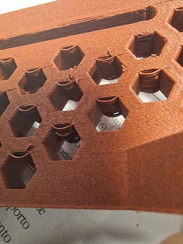

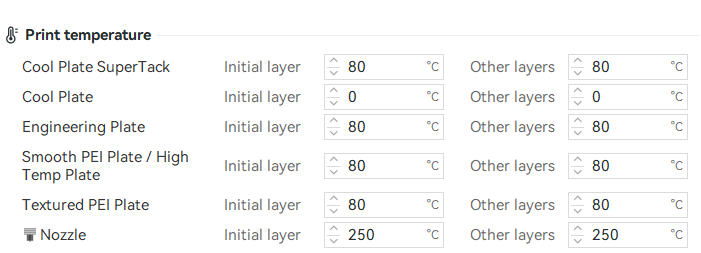

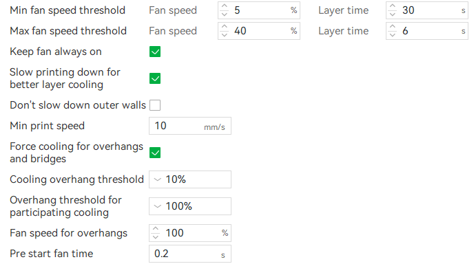

Hi, I’m having a problem with the bridges. My x1c doesn’t want to do them anymore. You can see in the photo that everything collapses. The bridge isn’t longer than 6mm. I’m attaching the parameters. Where am I going wrong? Thanks for your help.

Hi, PETG CF Bambulab, I calibrated all parameter, and I calibrated the belt.
I’m going crazy, help me…….hi
I think I’ve solved the problem. I had set the bridge flow to 1.5 as recommended several times by some reels. I reset it to 1 and everything went back to normal. Bye.
