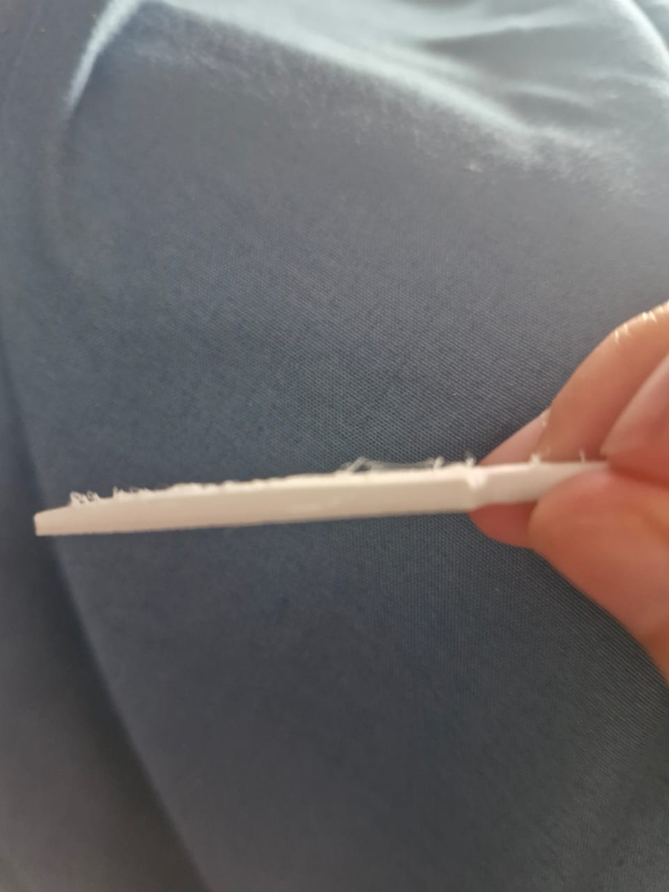

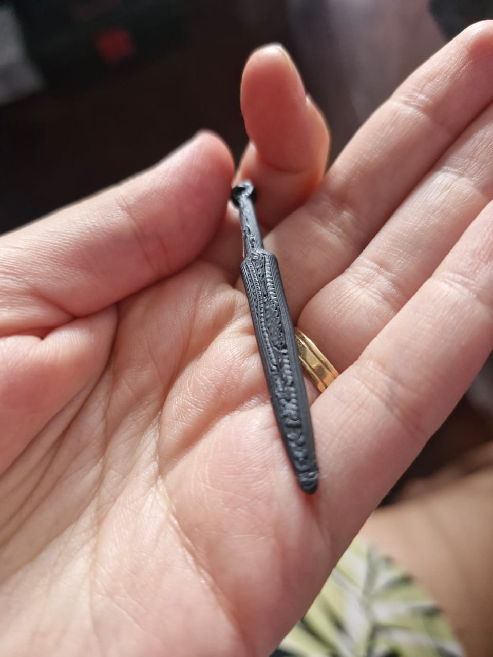

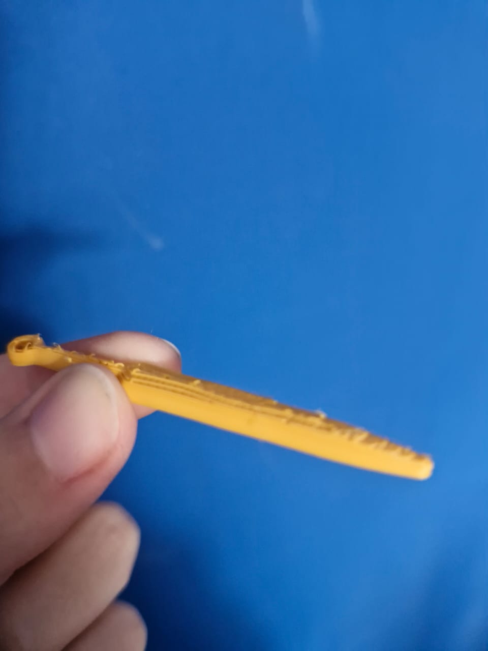

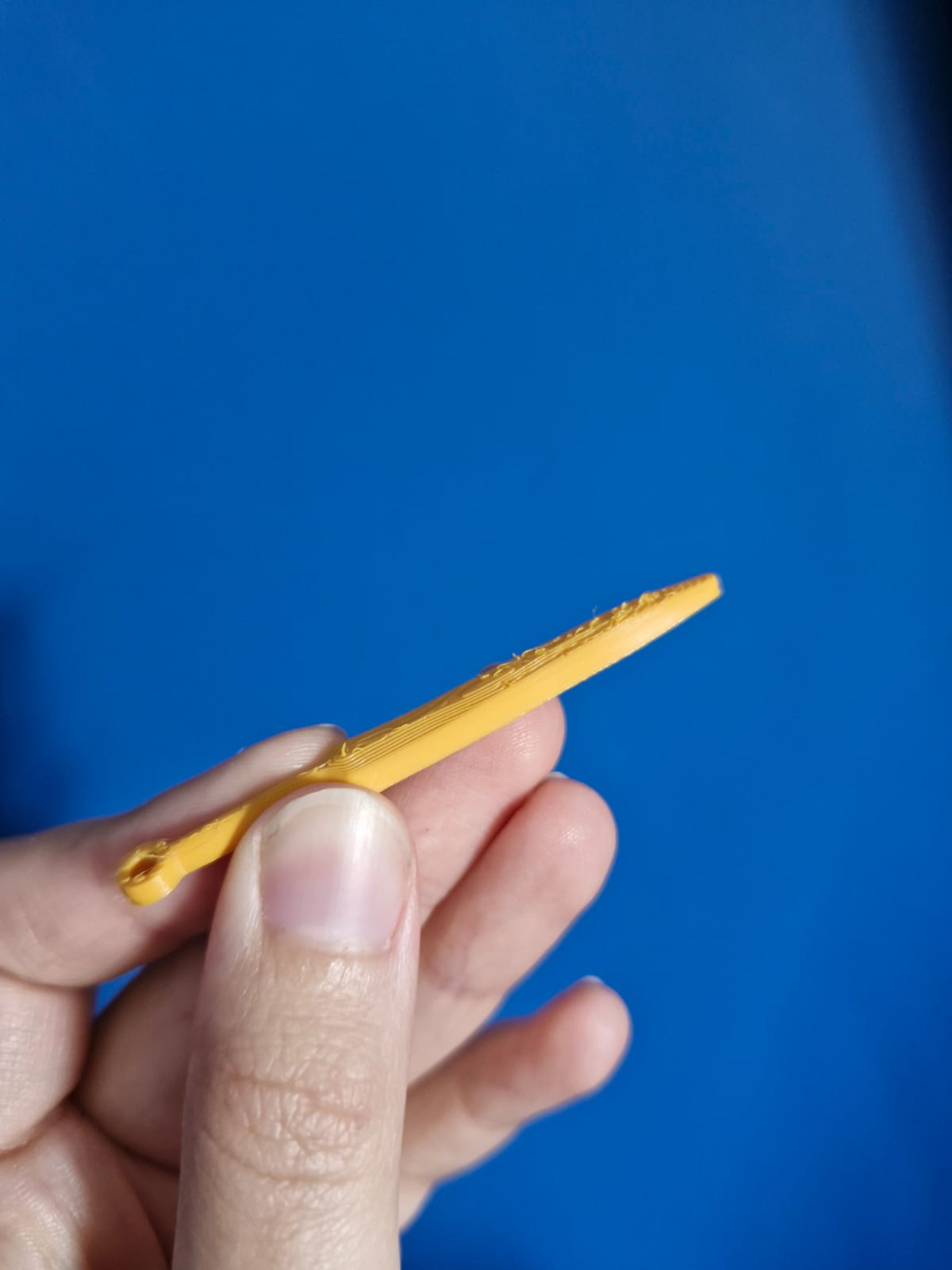

Hi everyone,

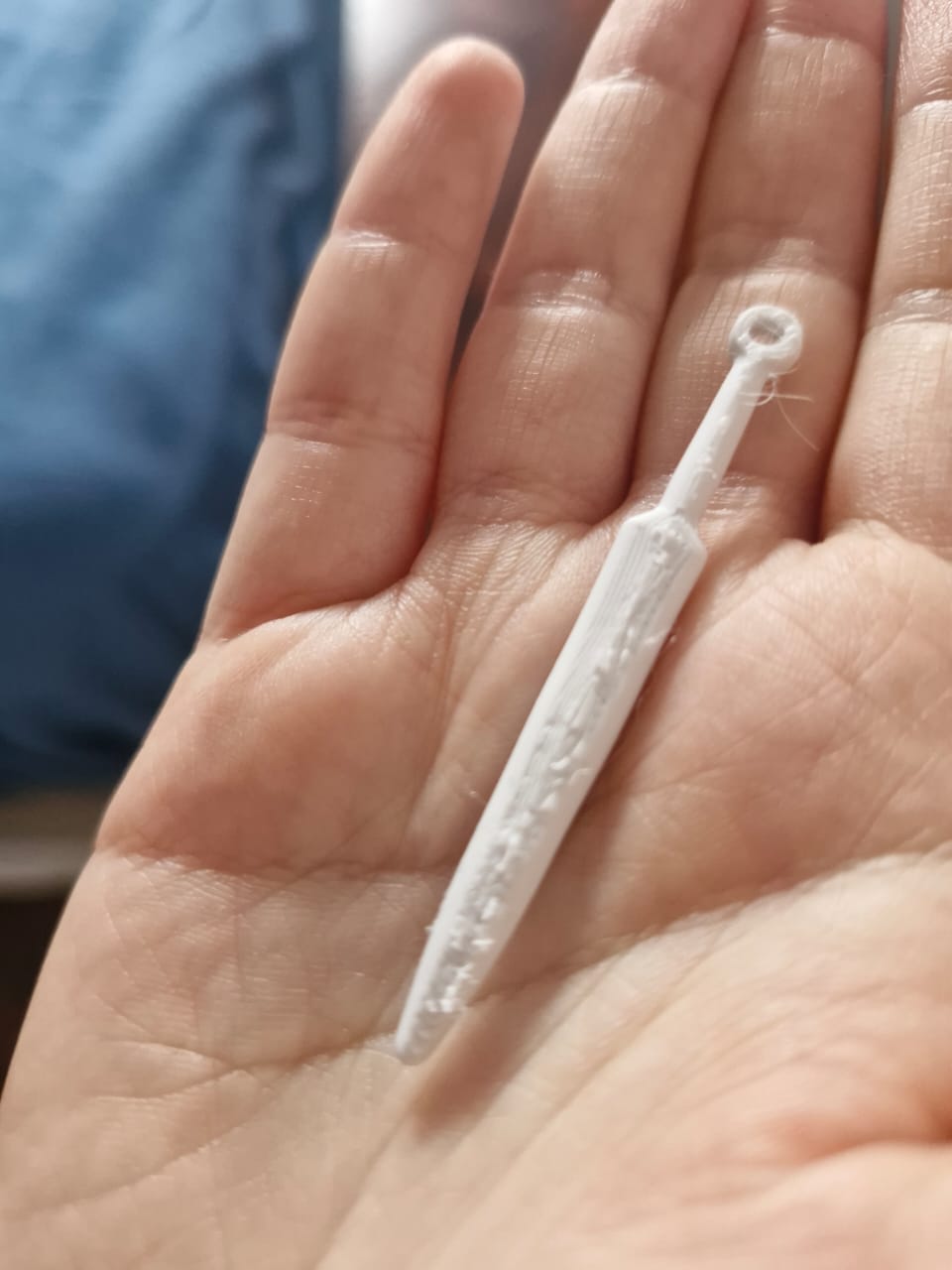

I’m trying to diagnose a surface quality issue on my A1 Mini and I’m running out of ideas, so I wanted to ask if anyone has experienced something similar. The printer is brand new, I ran every single calibration test twice and the issue persists.
Problem description
When printing flat pieces, the printer leaves small spikes or sharp bumps on the surface. They are sharp enough that you can feel them when touching the print, they even hurt your finger a little.
Observations:
  • The spikes appear when the nozzle lifts and starts a new line.
  • Long straight lines print perfectly.
  • The spikes appear at the start of new segments / direction changes.
  • During the final top layers the nozzle partially melts them, but the surface still ends up textured and spiky.
It looks like a small blob of plastic is deposited when extrusion restarts.

I am afraid I only ever see such heavy stringing with PLA with soaked filament. Blobs and flow dynamics issues fit with that.
After weeks at sea, all filament must be considered moist as the bags still allow moisture through.
Best to make it a habit to dry new filament before looking at settings. Even if it is just to rule it out.

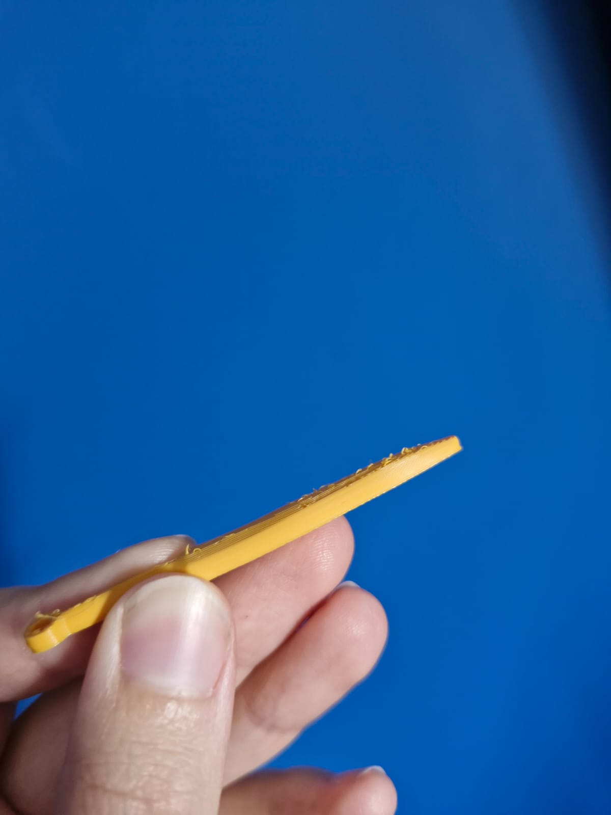

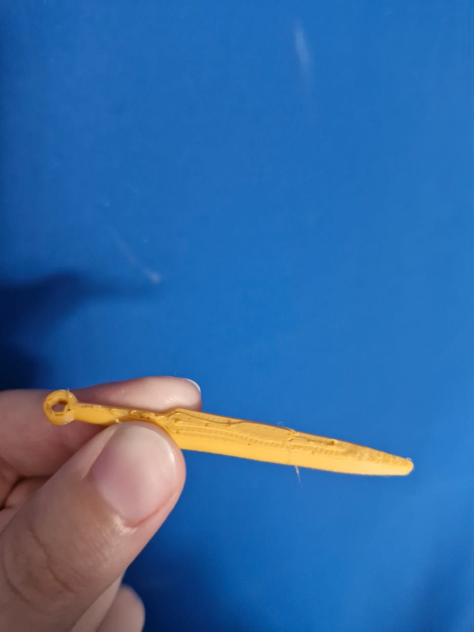

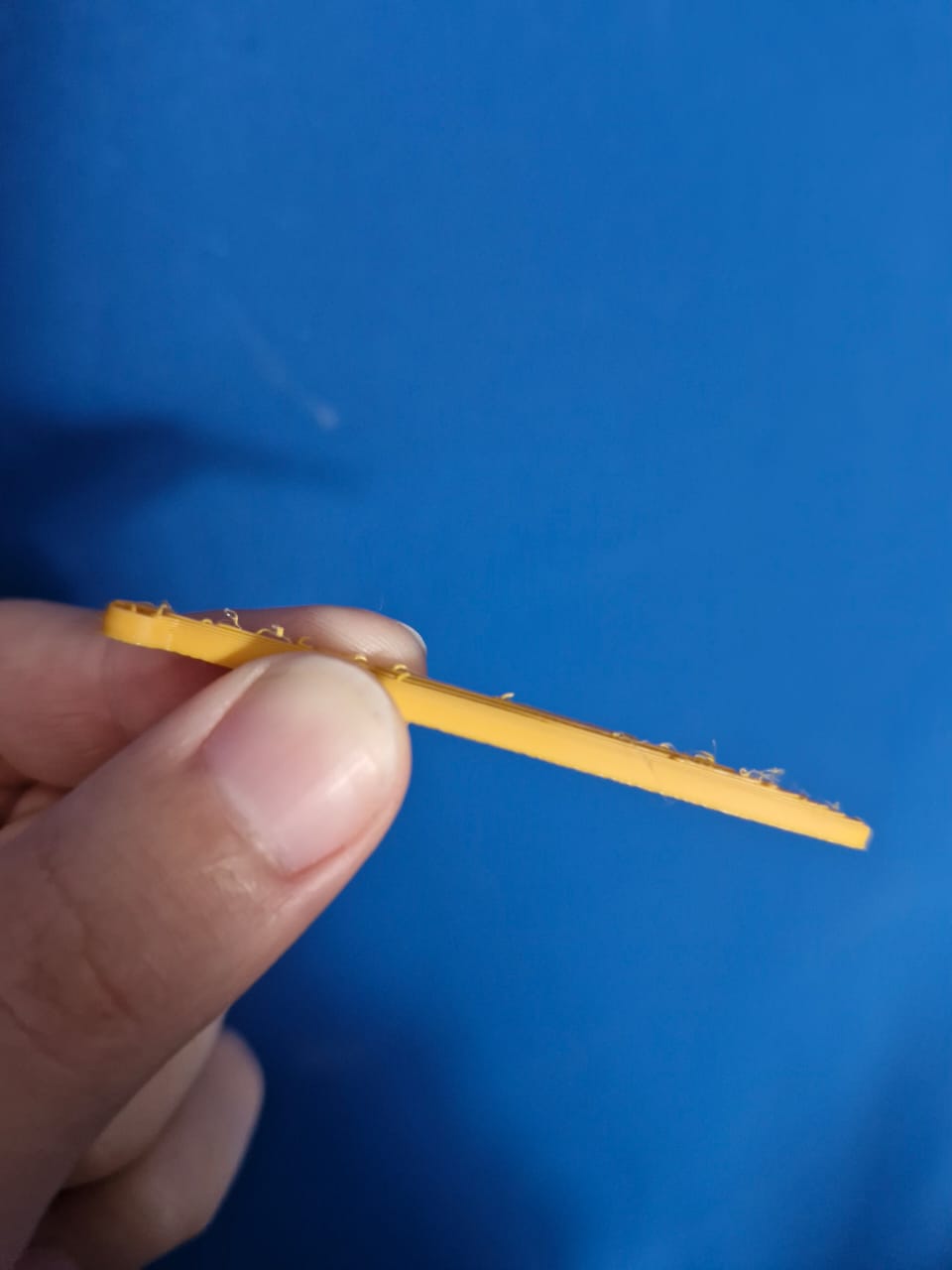

Hello! I just finished printing the same file, same settings as before but with the dried filament. I switched to yellow for a change, dried it for 8hs and still the result is the same :pleading_face: When I did the calibration for the flow the little rectangles looked just fine, no peaks or bumps at all, any ideas on what it could be or suggestions on what to look for?

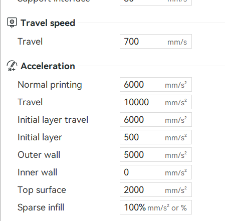

Well, the next step would be to revert all settings back to either generic defaults or manufacturer specifications (please post if you have them) to have a clear reference and only change key parameters for a very good reason. (Note: From your first post we know that you changed a lot but not what your settings were for the yellow sword)
And of course do the Flow Dynamics (!) calibration rather than the flow calibration.

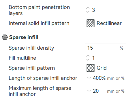

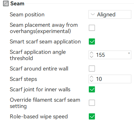

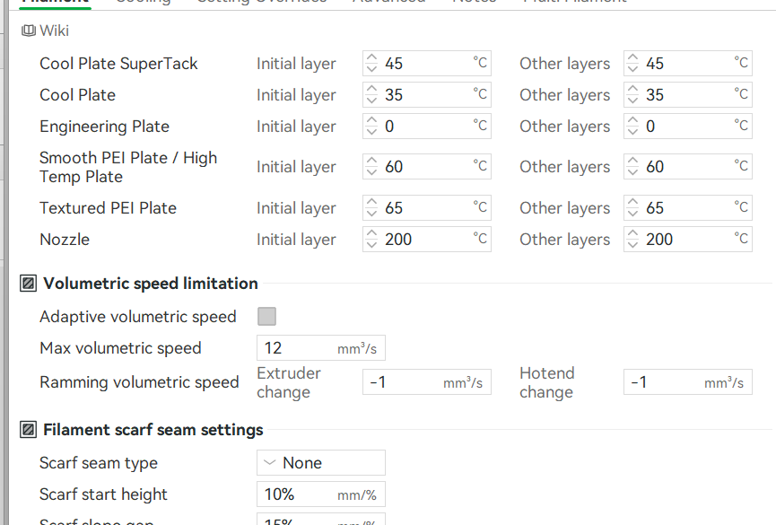

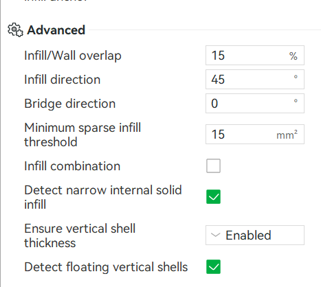

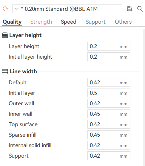

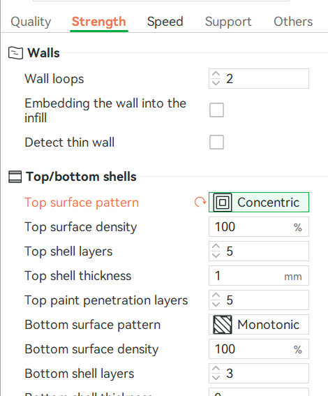

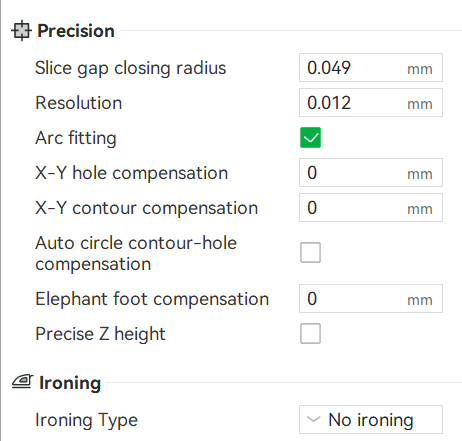

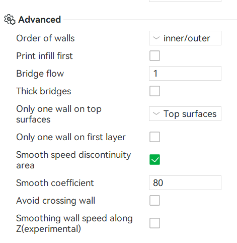

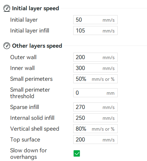

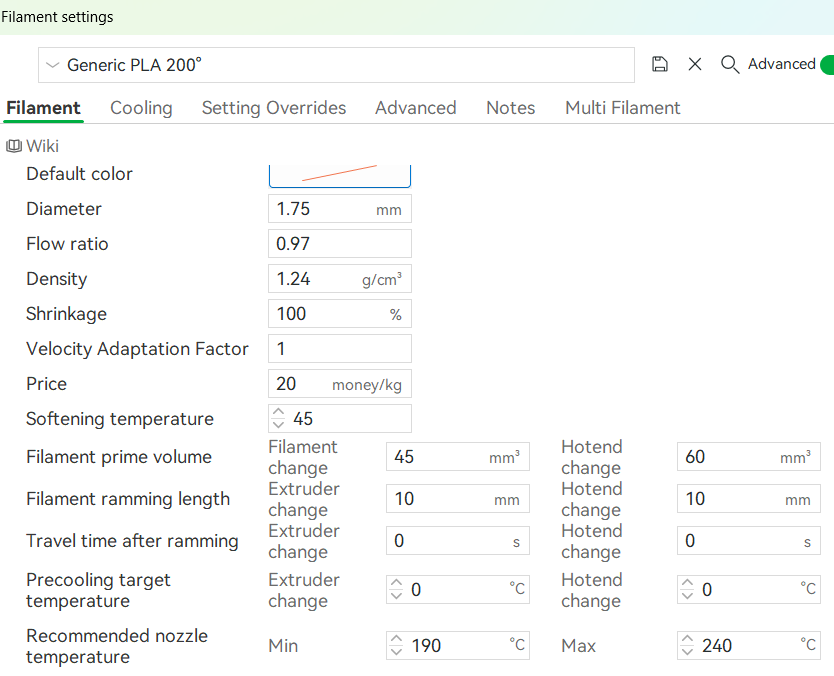

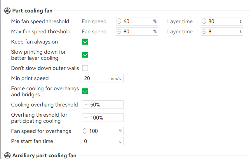

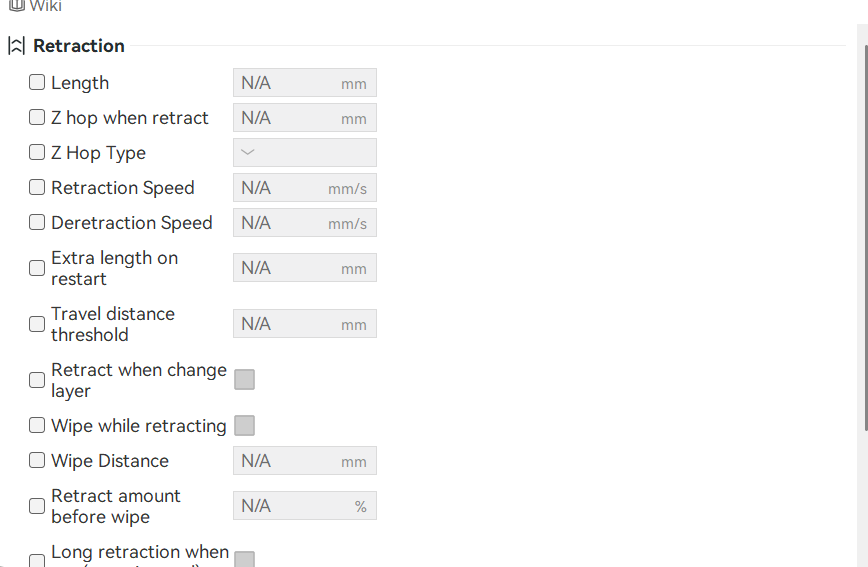

I just reverted all the settings to the default profiles both for filament and printing settings. here I attach some pictures. I changed to concentric pattern to try, but got the same results. I also lowered the filament temp from 220 which was the default to 200
The supports are turned off. Here are the settings for the filament

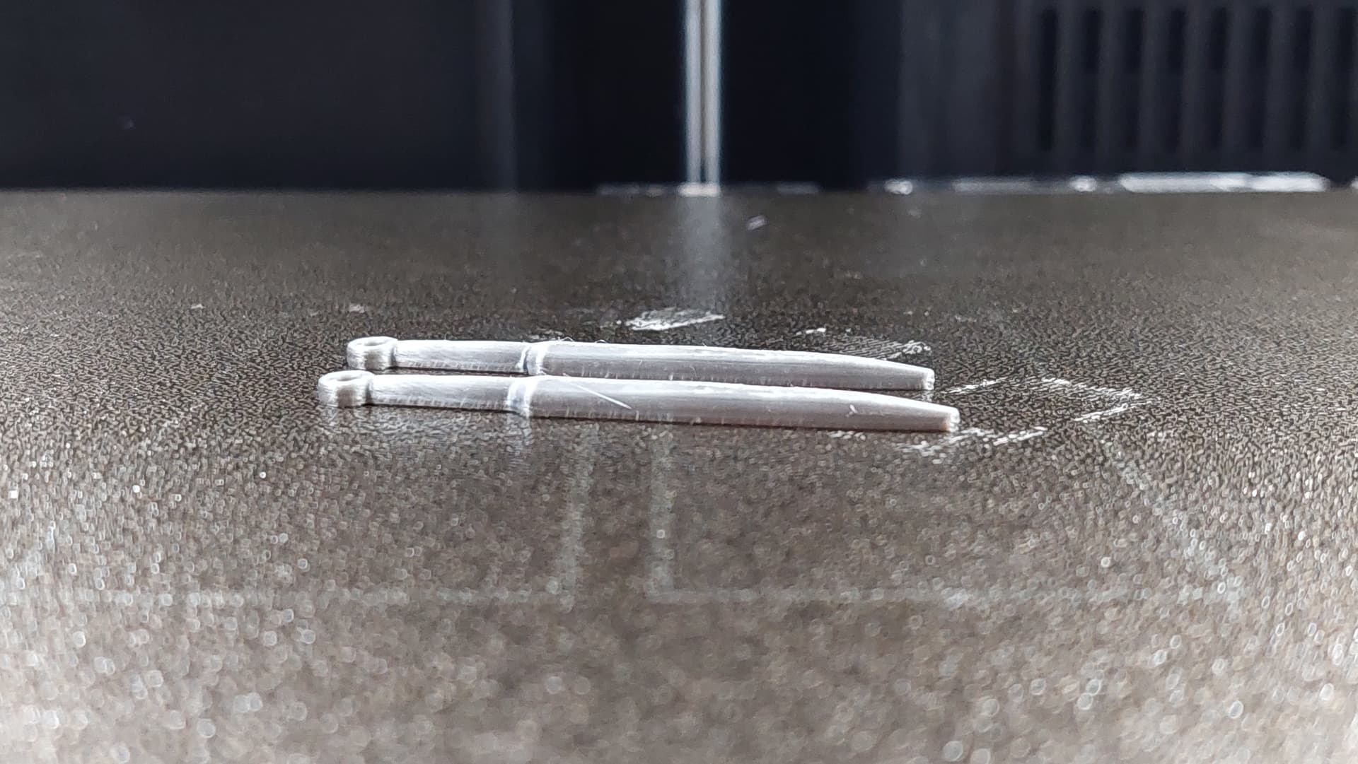

I tried printing a small cube, just to try something different and it came out super nice, no peaks no lines or bumps, using these same settings. I also tried scaling the model to 150% and it still looked exactly the same. I will try the arachne and adaptative layers and check how it goes.

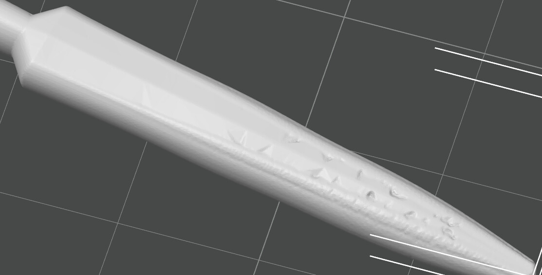

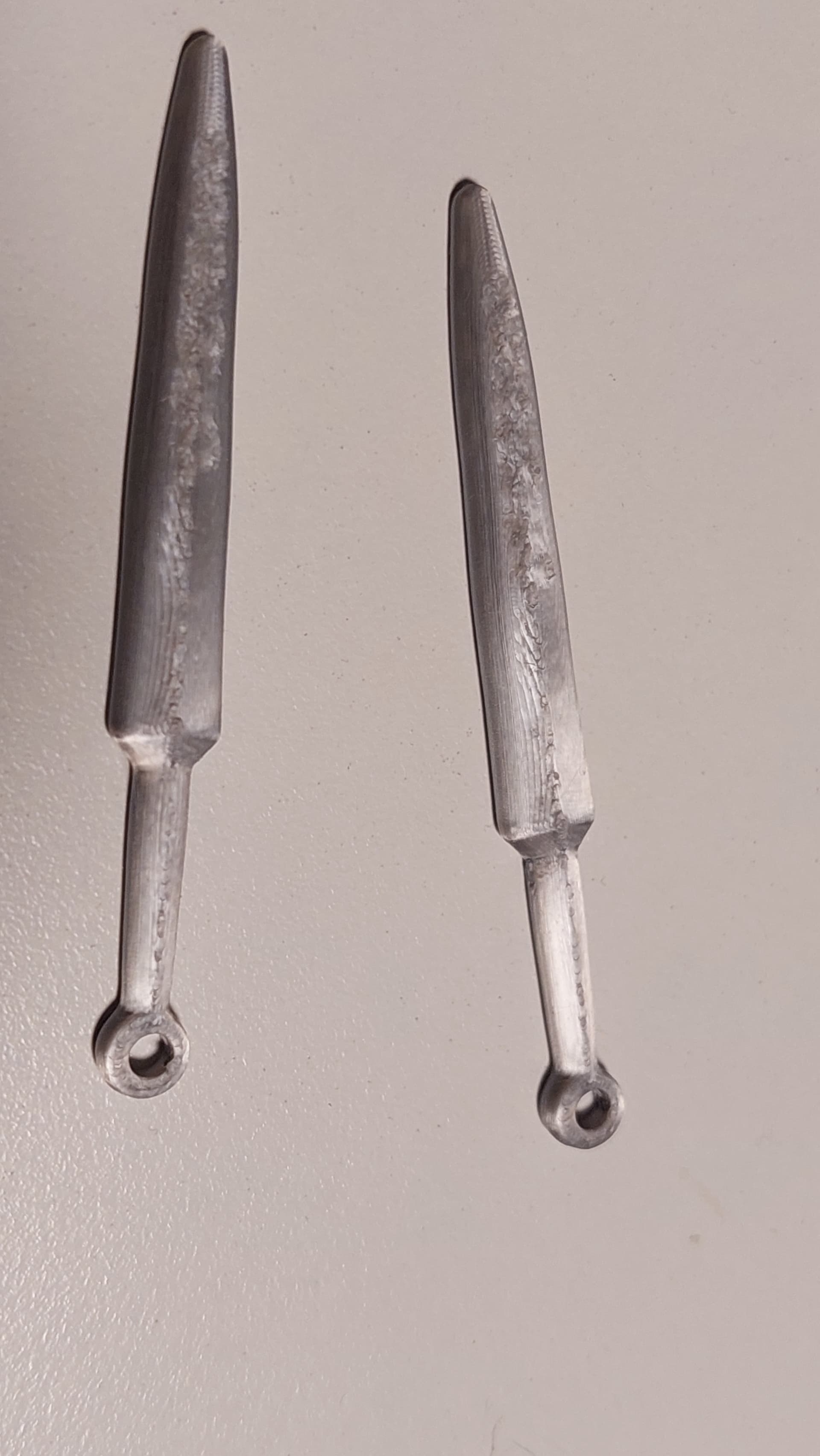

Look! It improved a little bit! The peaks are mostly at the tip of the blade now and the center is a little smoother. I checked the nozzle again just in case but I see nothing strange, no filament stuck and no weird looking tip. Any advice on which other setting to check? I’m so happy that it’s finally improving, thank you!
If you’re able to, sharing the 3mf would be nice so we could slice it and inspect the preview.

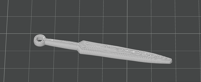

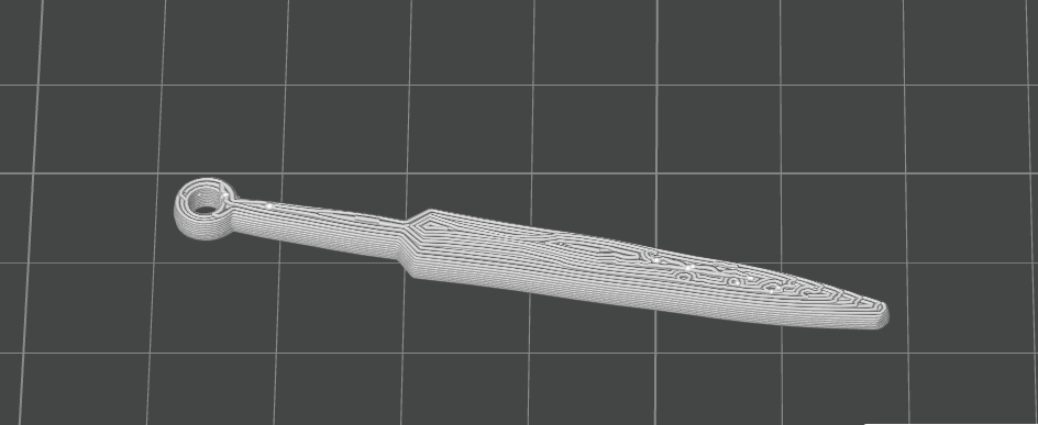

Or send a screenshot of the slicer’s “Line Type” preview showcasing this same area. Everything so far that you’ve shown looks within normal, aside from unknown flow dynamics [k factor, pressure advance, all of these are the same thing diff name]
Sure! Here is the 3mf
Needle.3mf (966.5 KB)
This is how it’s looking when I slice it. Can you please tell me a little more about the flow dynamics? I calibrated it once, but as I’ve been touching everything so much I’m not sure anymore

The top surface of the needle is really uneven and making the extruder do lots of small actions, so not exactly an ideal model - it’s gonna look a little uneven and “turbulent” from all those small paths.
That being said, the machine should be able to do it. I think you should redo flow dynamics / k factor.
