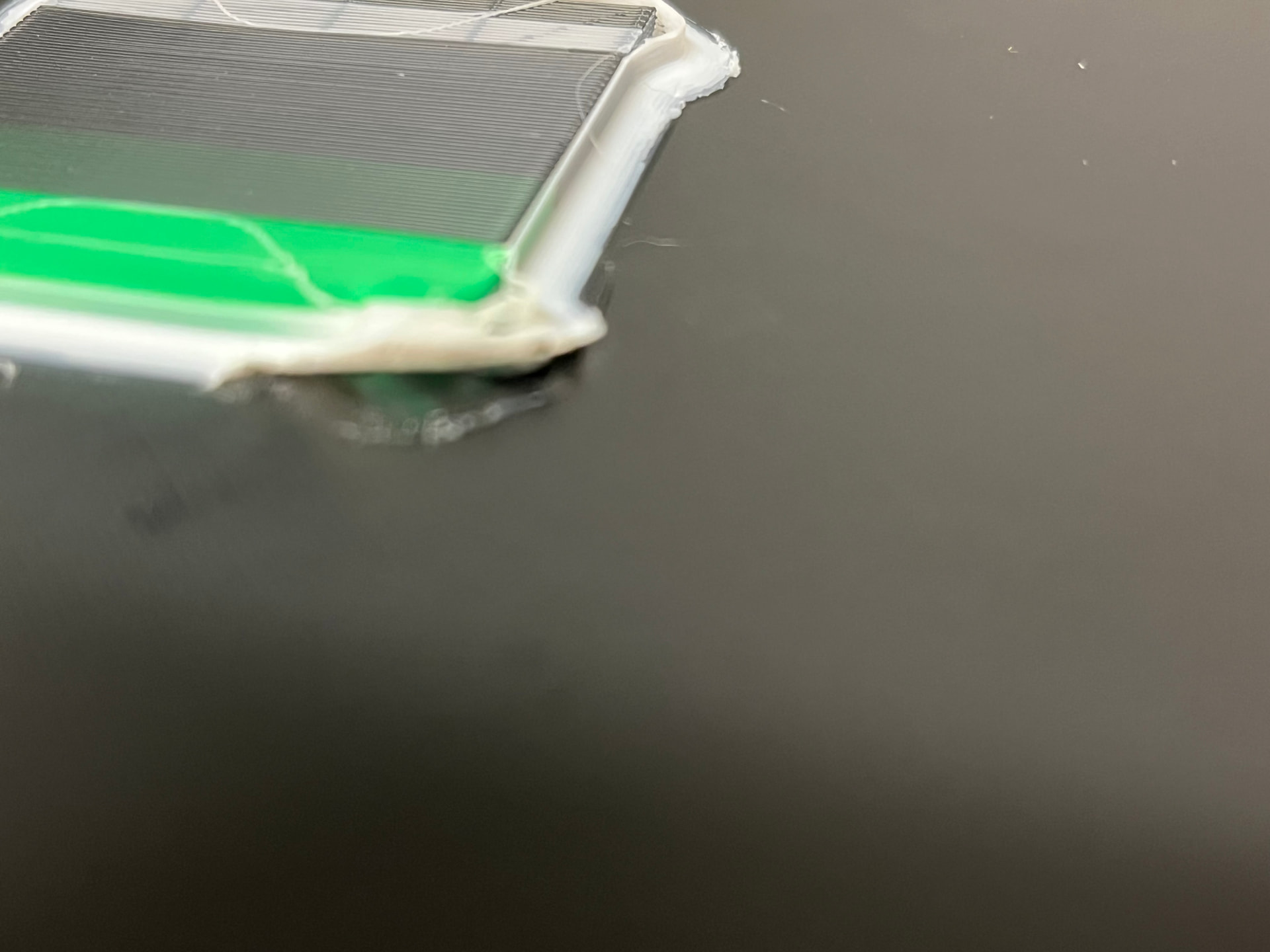

Hello, I just tried my first print with the Smooth PEI Plate, and when I was pulling the print off the plate, it was incredibly difficult. I then tried to remove the filament colour changer, and I peeled some of the surface off. I printed on A1 with a 0.2 mm nozzle. I’m not going to peel off the filament colour changer as I am too scared to ruin the plate. Pls Help!!!
What kind of filament are you using? You need to use glue for anything but PLA which acts as a release agent.
you dont need glue!!!
put the plate in the freezer and bend it for release the part.
a thicker part is always bettter to release.
use a non metal scraper
