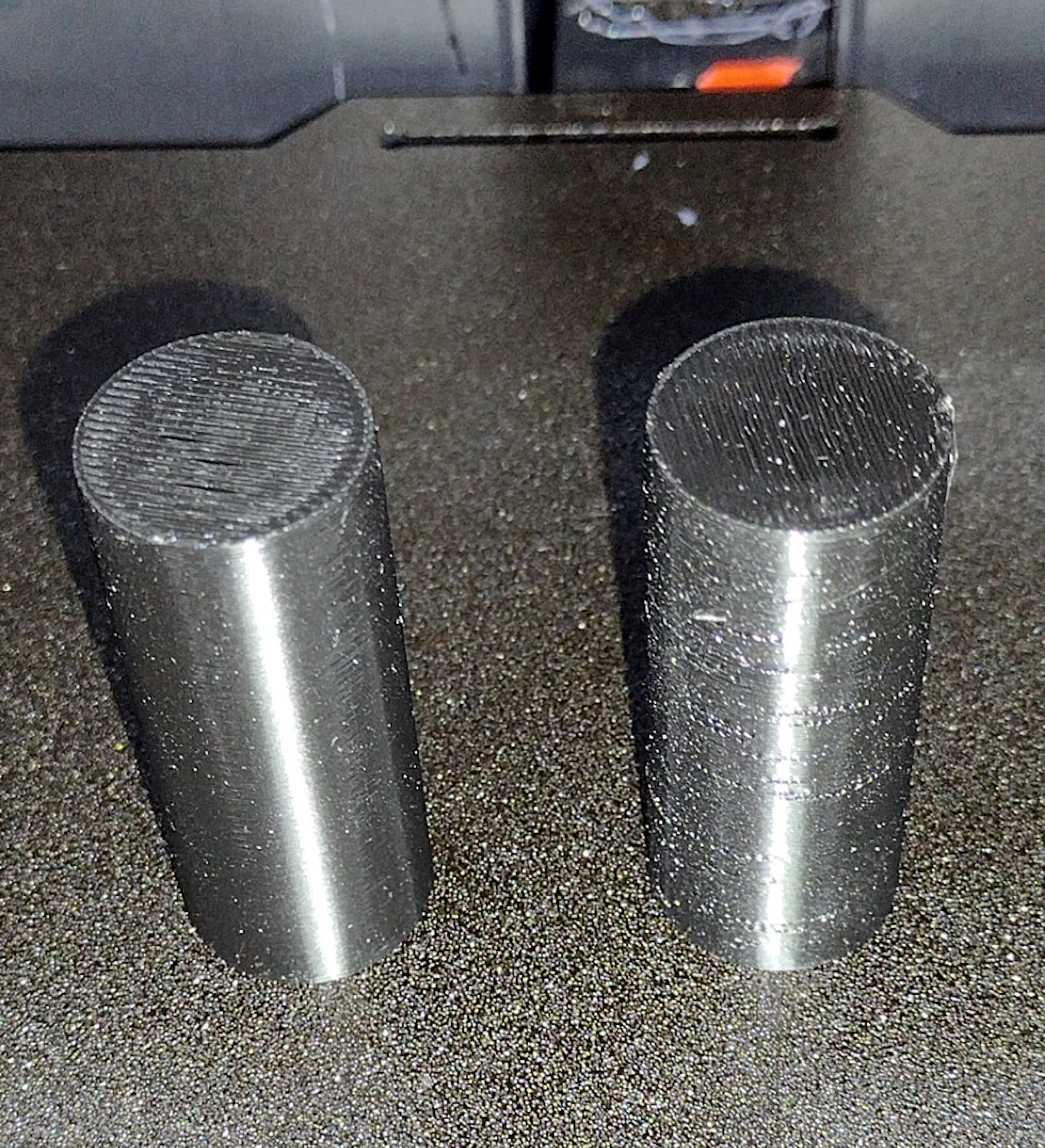

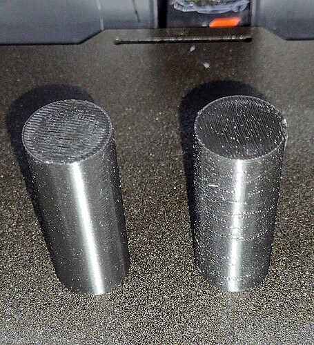

Here’s a clear example that happened to me today. Same spool, printed before and after drying. No other variables changed. One surface is smooth, the other pitted:
Sorry for the crappy image, black is so hard to photograph and there was a lot of dust in the air, the negatively charged print clearly was attracting dust even though I used and air can to spray it off.
This was a brand-new spool:
Before drying: 1161g
After drying: 1154g
That’s a 7g loss—just 0.60%.
Worth noting: it was a cardboard spool, and blank cardboard spools alone can shed 3–5g of moisture. Plastic spools remove that variable, but most budget brands use cardboard. I’ve tested that myself with empty spools that I placed in the dryer and can confirm this.
This filament was 3DJoHor PLA—$10–$13 per spool on Amazon. It came in a 2-pack; the other spool had no issues, so that might suggest that even during the manufacturing process, there may be variables in moisture.

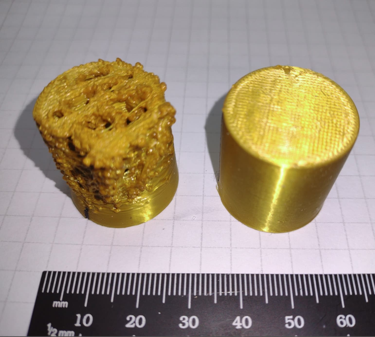

The brand isn’t the point. Similar results have been seen with Elegoo, Anycubic—even factory-sealed Bambu Silk that I’ve posted previously(see below):
Truth be told, I assumed the problem was something else. But I tossed the spool in the dryer before I went to bed, and when I printed again the next evening—same model, same Orca profile, literally hit “send” on the same screen—the difference was obvious.
Would I have believed that a mere 0.60% weight change could fix it? Probably not. But here we are. The only thing that changed was moisture content.
