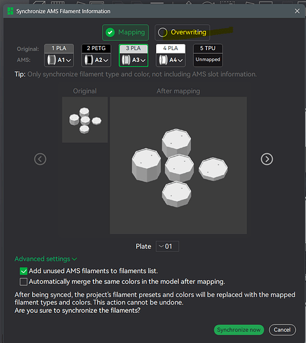

Choose “overwriting” and you will see the filaments as loaded into your AMS and you’ll be able to select the one you want.
Thanks!
I still did not do the update, but seeing your solution makes me think I should do it.
Really appreciate it!
