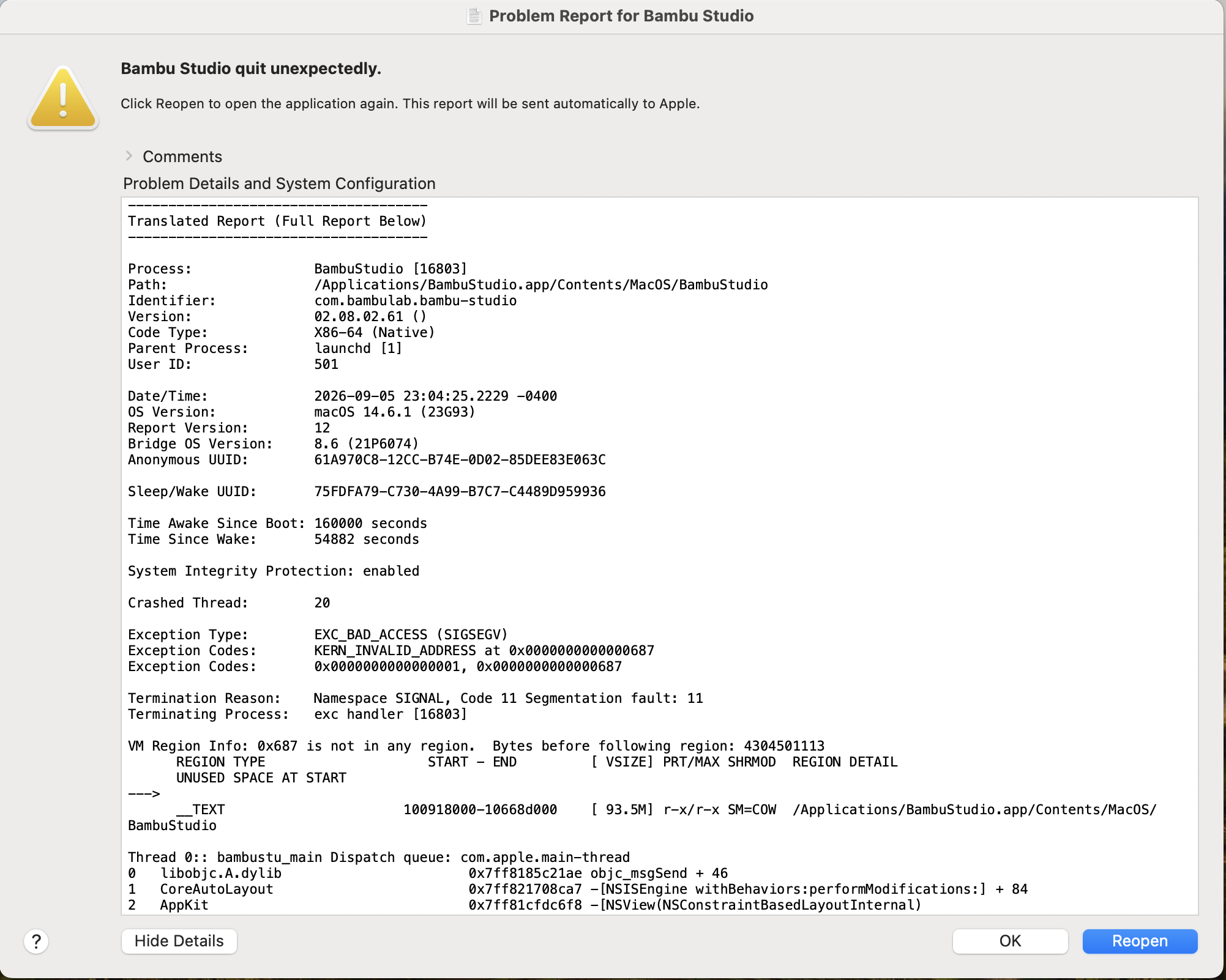

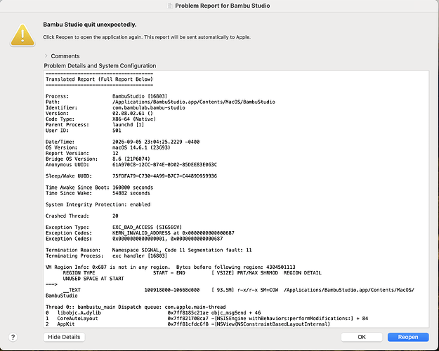

I don’t know if this screenshot mean anything?
I’d suggest downloading the latest non-beta version. You’re running a beta version right now, so you are more likely to hit bugs.
Oh, That beta version was probably from the older version I tried downloading earlier. The new version I have is 8.2.8.61. I that the one I have troubles with.
