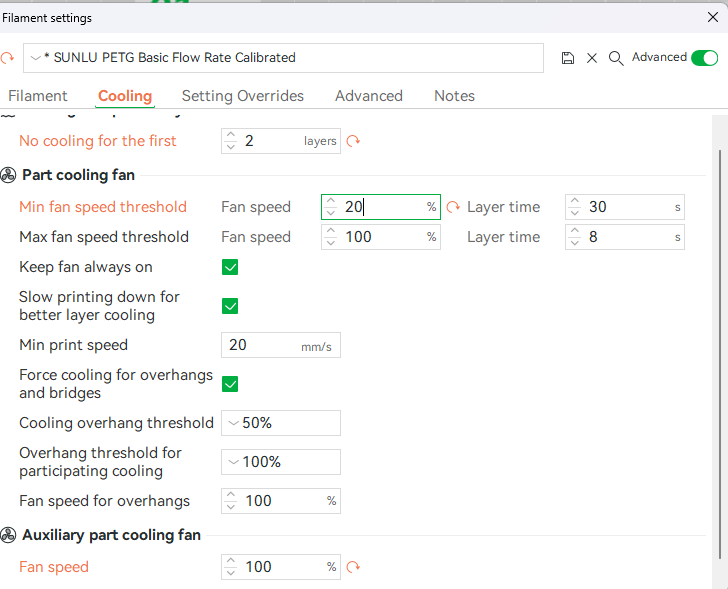

can you send a screenshot please from the settings?
That?

Are you saying that the Orca Slicer has some calibration tools or is there another tool in the repo for calibrating filaments?
How often are you printing with the Sunlu high speed PETG? If you’re printing with it often, do you mind sharing your settings?
