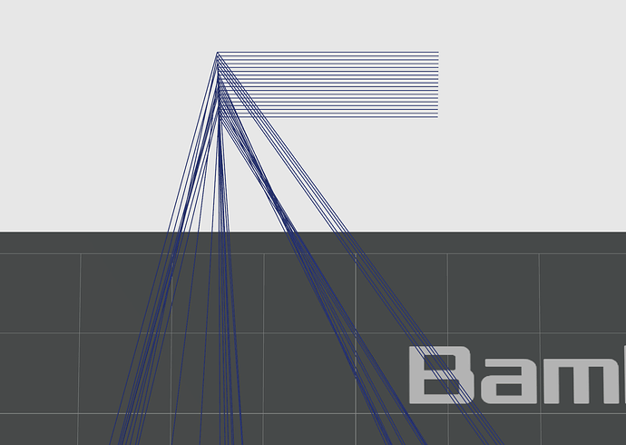

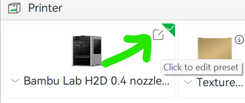

You would have to manually insert that in the G code file which is very tedious (even with AI its another step)
So I figured out you can put it in the layer change machine G code section and have it run every 10(or any arbitrary interval) of layers!
Since it is hard to find that setting location I made this screenshot

Here is an example of the travel movements generated - they look like Z is changing, but the cleaning station is in relation to X and Y only not Z so it does not matter.
