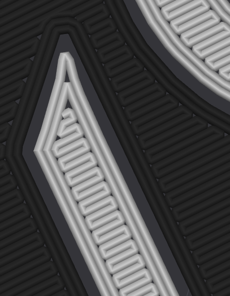

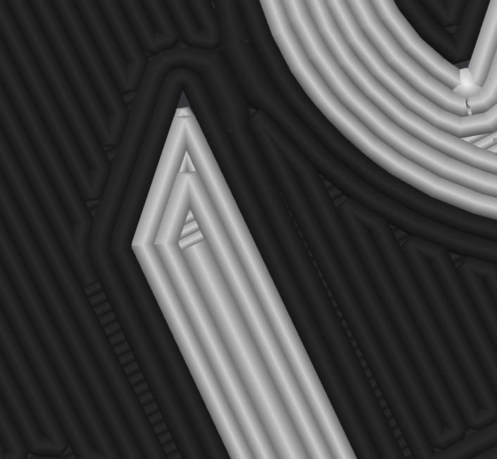

Hi,
Recently, problems started occurring with multicolour prints on the first layer only. Second layer is fine. There is an unexplainable gap between the two colours on the first layer only. Maybe it started after updating to BambuStudio 1.9.3.50. It’s driving me nuts, since I put LEDs behind this surface an light now bleeds…
Any suggestion would be welcome.
What you are seeing is there by design. It’s called “Elephant foot compensation”.
https://wiki.bambulab.com/en/software/bambu-studio/parameter/elephant-foot
It can be adjusted in the slicer.
Thank you so much. I was not aware.
