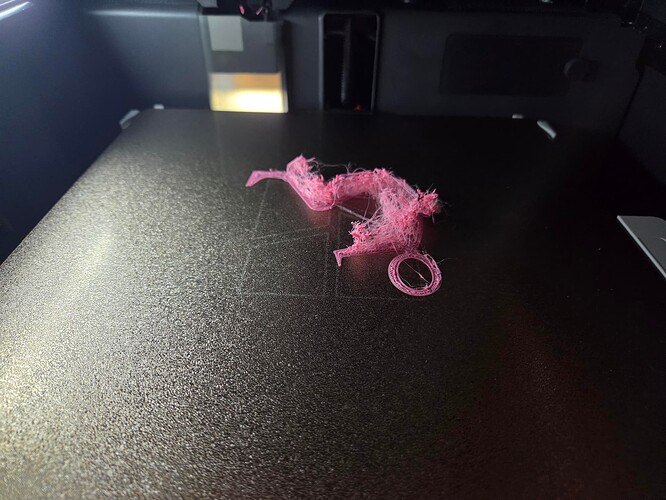

Last week printer started to speghetti in the middle of a print. Discarded it, shut it off, came back in a week, tried a different print/different roll on the AMS, and started to print like the picture attached.

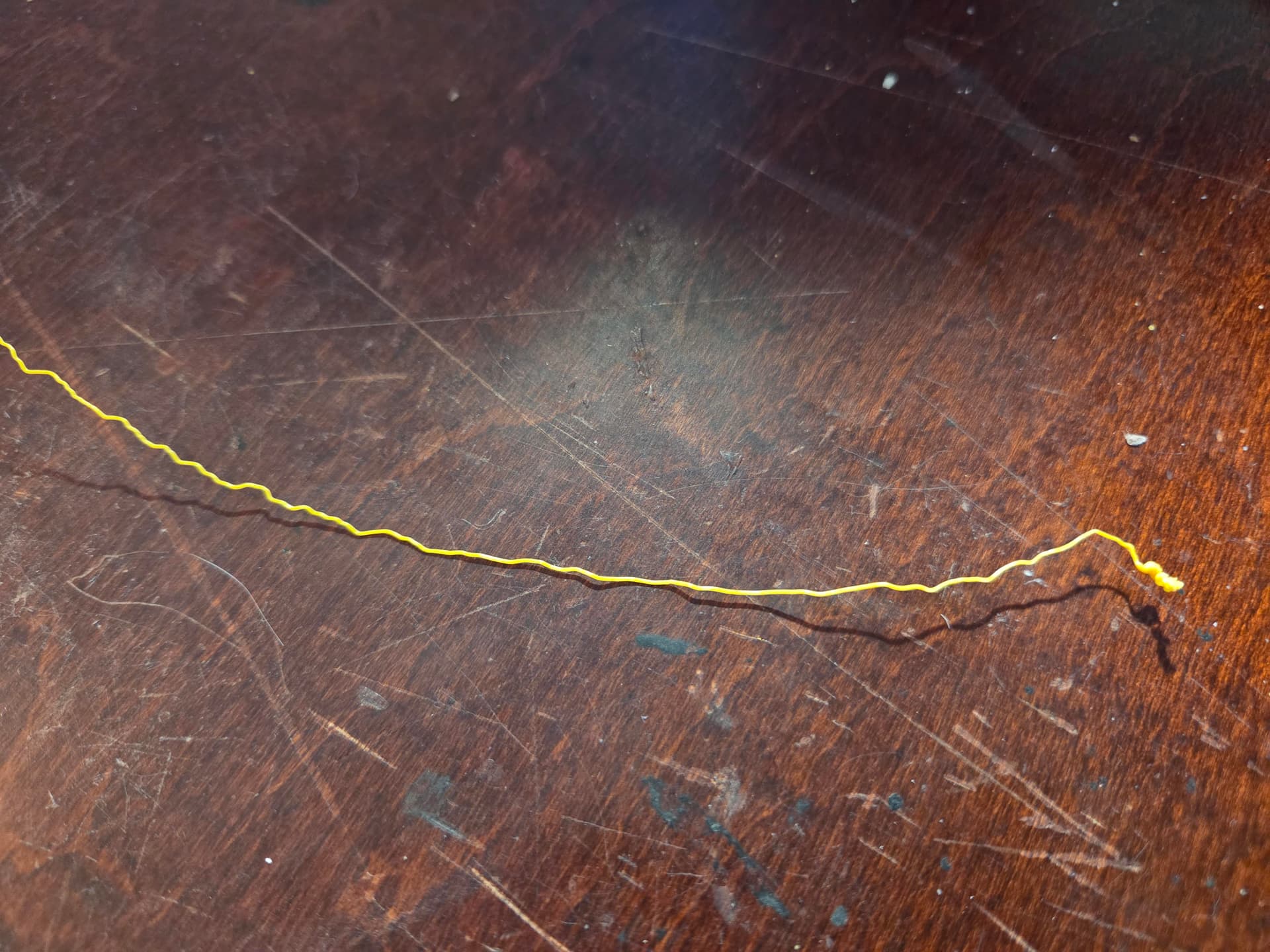

If your “squiggle2” picture came from a nozzle parked in a fixed position, just extruding via manual command, then I would address it as a partial nozzle clog - cold pull and/or needles. If it was from a moving extruder, as part of a print that was just airprinting, it looks normal.
The pink picture is harder to tell. If thats stuck to the bed still, then probably clog, if its detatched and airprinting then the plate really had no adhesion, that sorta shape and profile I would categorize as “good” for adhesion. If it all pulled up, then I’d analyze your cleaning procedure. The goal is to dissolve oils and contaminants, and flush them all away, so make sure you’re cleaning well. Hot water, Simple dish soap, Clean non-dish-use scrubber, clean drying towel.
Thanks. Squiggle2 was the test duck in yellow that flat out didnt stick to theplate, and that was just the filament that just was stuck to the end of the nozzle.
The pink one stuck, or started to stick (mostly) and then just squiggled.
The original time this started - I was printing a tall light box in black - it printed the walls about halfway up - then the spaghetti started.
Sounds like I have a partially clogged nozzle and a dirty plate then - can anyone direct me to a good web link on how to clean the nozzle? First time, so Im a bit of a neophyte at this.
The wiki has it here:
The goal of “coldpull” is to melt a big puddle inside the nozzle, hopefully including whatevers clogging it. Let it solidify completely, then apply rapid heat and pulling force, so that the moment the “frozen puddles” walls contacting the nozzle melt, the whole thing gets yanked free. Like removing a gelatin from a mold by pouring hot water on the outside. :wink: I find it to be the best and most effective. You can try using needles too (likely came with the printer) to poke into the hot nozzle from below, if something really needs mechanical breakup.
Never use alcohol. It just dilutes and spreads around the grease.
Dish soap, warm water, clean nylon brush (ikea dish brushes are great). Dry with a piece of paper towel, not a cloth towel as fabric softener can transfer to your build plate.
