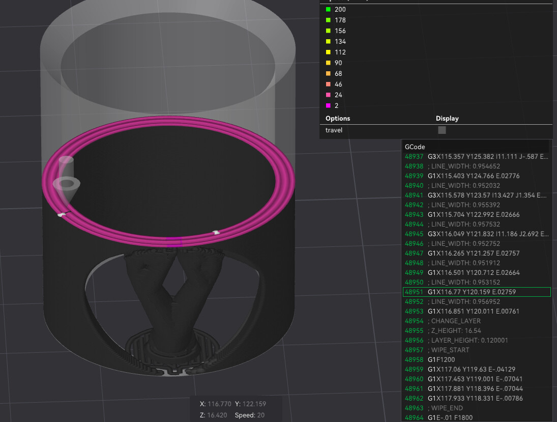

Hey guys, I’m trying to print at 20mm/s throughout the ENTIRE print, other than support. I’ve limited pretty much every speed setting I can in every setting except for acceleration values and travel speed. For context, I’m printing to get the clearest finish possible, so speed needs to be low.

Before speed change g-code:
After speed change g-code:
My speed settings:

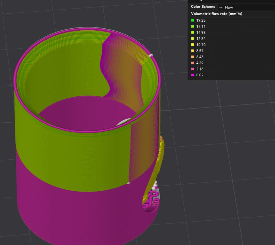

Flow also looks really wonky:
Flow rate goes higher than my max flowrate as well:

The “wonky” flow you showed is normal for scarf seams, but being above declared max isnt

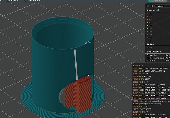

Steps taken: Taking your file, hitting slice, going to preview, selecting speed

So I didn’t figure this out at all. I’m probably more confused after fixing it. But I found a solution if anyone else has had this. Pretty much turn off “Slow down for overhangs” slice the plate, and it’s fixed. You can even turn it back on and slice it again and it will work.
Removing, readding, and reslicing the part will reproduce the same issue, and can be fixed by changing the setting like I described. Will definitely be sending in a bug report to bambu.
