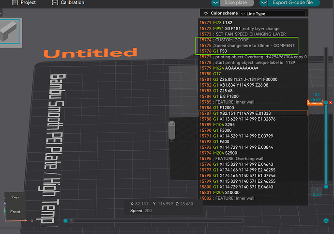

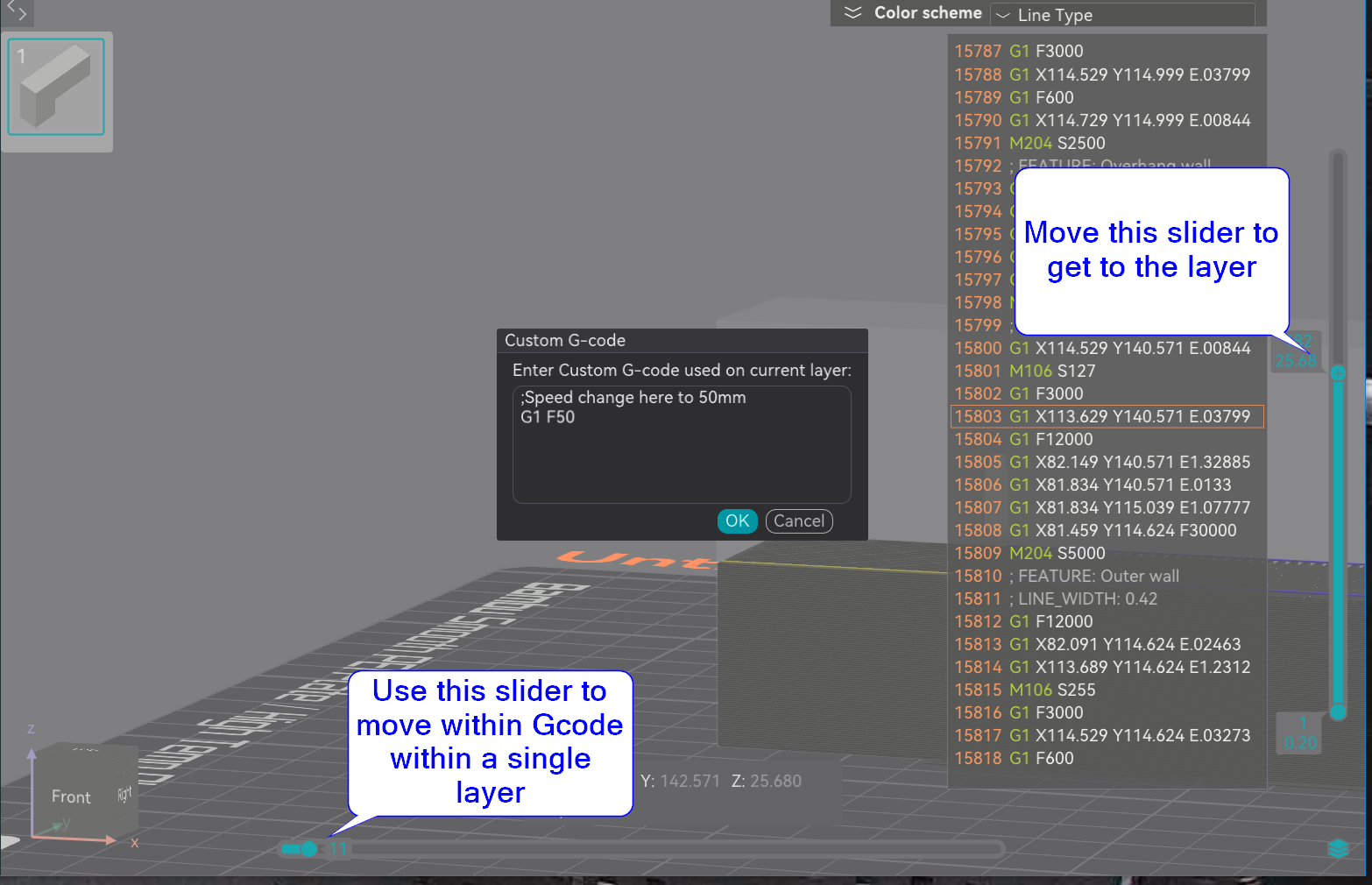

  1. Slice your model and in the preview, slide the layer slider to the layer you want to manipulate. Right click to bring up the customer Gcode menu.
  2. Then use the bottom slider to slide to the left which will move the Gcode to the beginning of the layer. You will actually see an animation of the nozzle movement letting you know when the Gcode position is in the right location.
  3. Enter the command: G1 F50 ; Set speed for this layer (50 mm/min)
Note that this will change the speed for that entire layer and may introduce and undesirable 'visual" line due to the filament cooling at a different rate.
