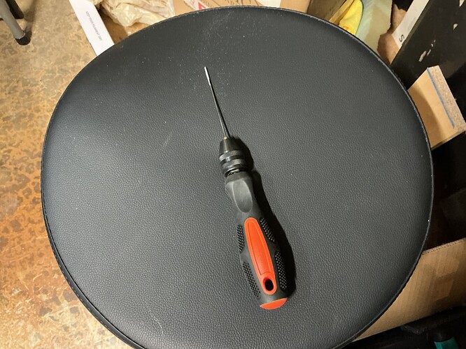

the printer was doing good but when it came to the part where I had to switch out the filament and it did the back and forth thing. I know why it is doing that now though. There is a fragment of filament stuck inside the toolhead and it thinks that filament is in there, so it tries to pull it out, after doing this for the amout of time it would normaly take to pull it out, it goes to print again, than it senses the filament fragment and does it again. the problem now is that I don’t knnow how to get it out. Any Ideas? :thought_balloon: :red_question_mark:
I have had the same problem with small pieces of filament getting stuck in my A1 and what I have done is purchased a pin vise drill handle and some 1.6mm steel bar stock and made a tool that I can use to purge the heated up hotend
where did you get those and can you send a picture of the tool you made?
I purchased both from Amazon. It costs less than $15 and I got the idea from the Jamwich which is offered through a 3d printing site https://cookiecad.com/products/jamwich?Print+technology=3D+printing
