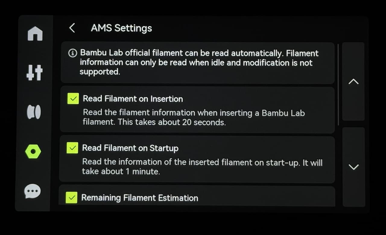

When I change spools the RFID chip isn’t read/recognised. I end up having to edit the material on the printer. Isn’t the point of the RFID chip that I shouldn’t have to do that?
Or am I doing something wrong?

Hi @retrolenzil
Do other spools work?
Is it a refill filament?
Can you try do the reread? If it still cannot read the rfid via manual re-read process, then there’s something wrong with your rfid.
This is for both spool-bought and refills.

It should only happen when you previously assigned a manual profile (for a non RFID spool) and never re-read the rfid
Is the procedure to reload a new spool? I’ve just been taking the old one out and replacing it with a new one. It recognizes that I’ve removed a spool and that I have put in a new one. It just doesn’t read what the new one is.
It’s really unlikely that you got multiple spools all with defective RFID, but is a possibility. If you still have a spool that was known to have read successfully at some point:
Rack it in #1. does it detect?
Remove from #1, Rack it in #2. does it detect?
no/no, no/yes, yes/no → factory reset. Try again. Same result? open a support ticket about your AMS
yes/yes → good to go

mine was the same, however, i turned off the printer, waited 30 seconds, and turned it back on. Then, it pushed all the ams spools back through again, and it worked just fine
I think under AMS Settings on the panel, there’s a “Read Filament on Insertion” Might have gotten unchecked sometime.
I’ll have a look at that. Cheers!

Yes. Don’t know what I did wrong in back then, was definitely user error though i.e. me. All good now.
Today I had the same issue after a failed print. I had to unload the last used spool before the AMS read the newly loaded spools again. Hope this helps someone.
Had this also, and the humidity was at 0, i just unplugged the cable, waited 10 seconds, than plugged it in again. After this it worked.
