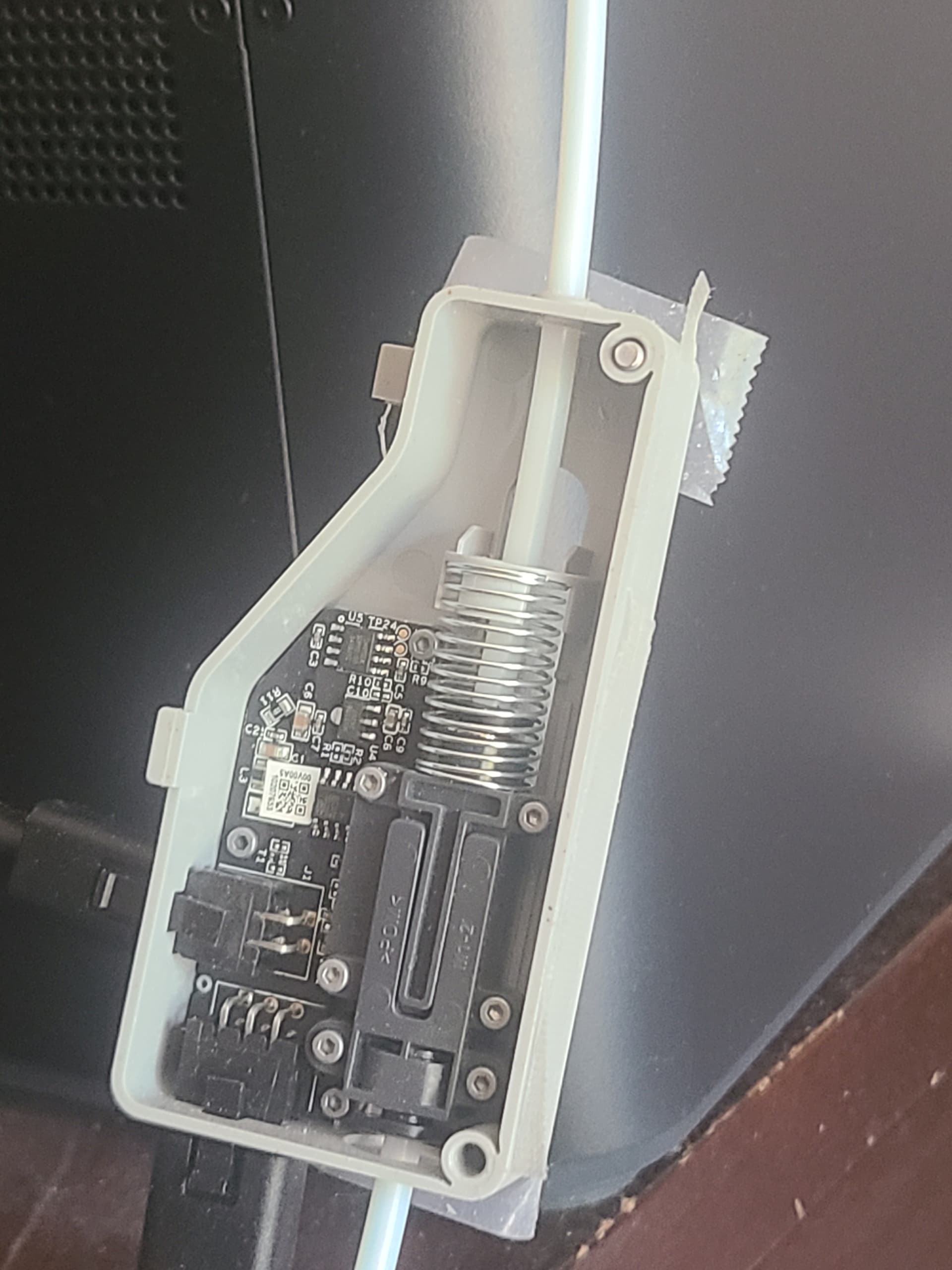

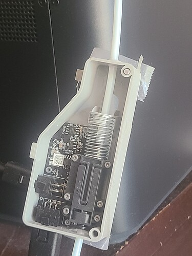

here’s the spring

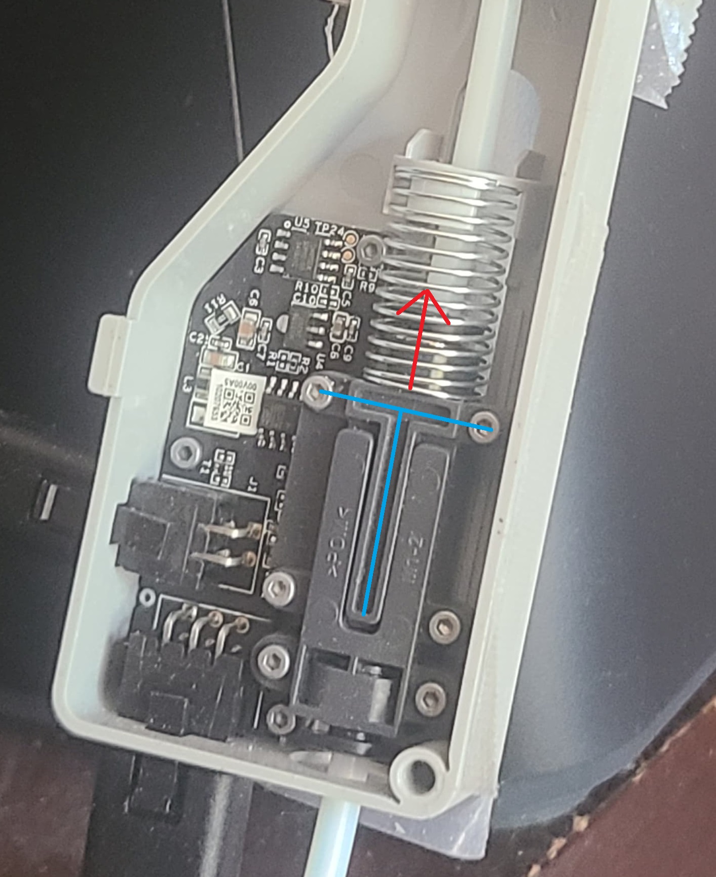

Are you able to move the highlighted blue section in the direction of the red arrow? Does it catch anywhere?
You should be able to print with the buffer open as shown in the picture and see it “buffering”.

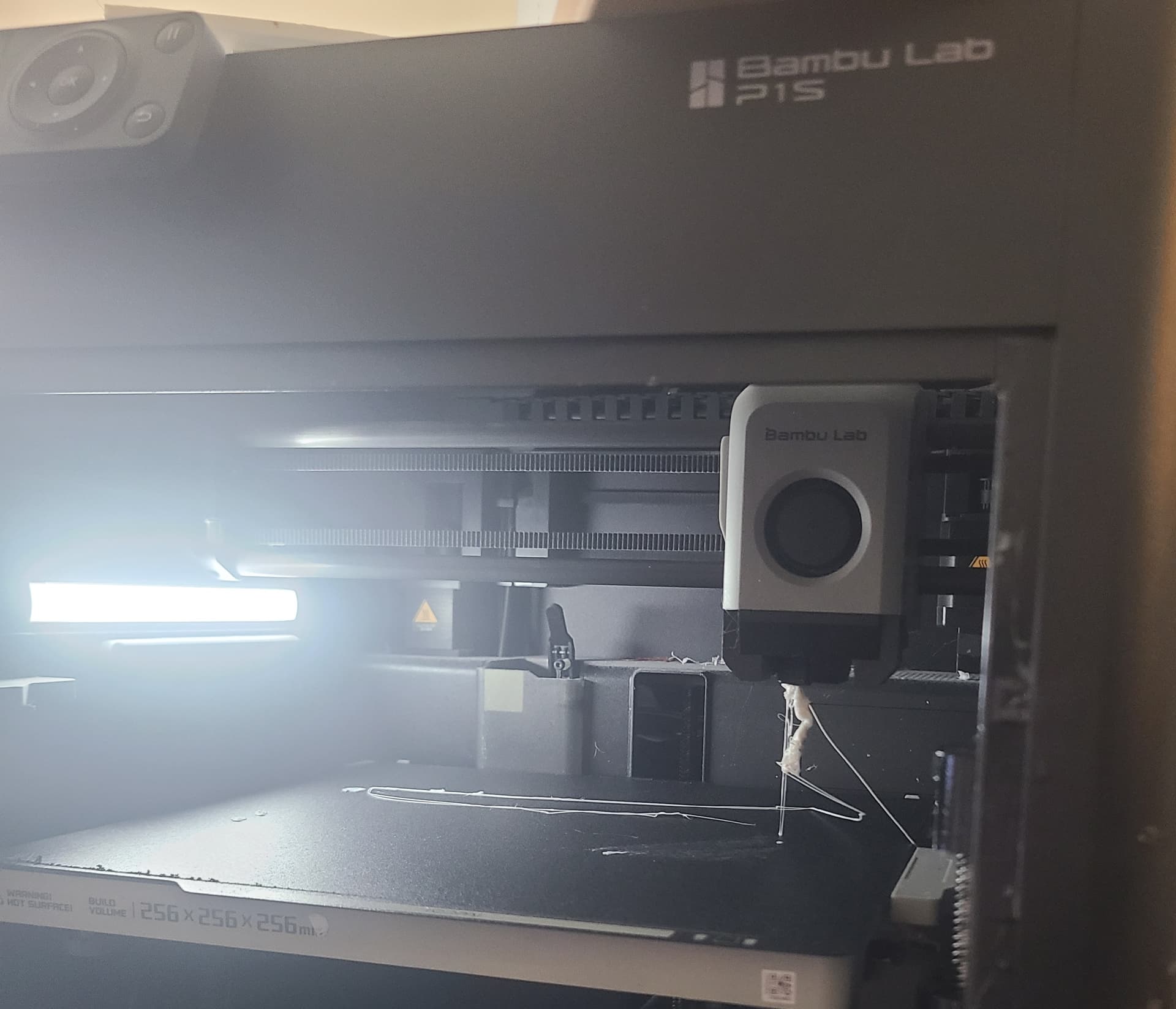

Are you able to provide picture(s) of the failing print? Clumping and dragging is often an adhesion problem. There may be separate problems occuring.
They give a description of how the buffer works in the wiki. It releases and compresses spring to feed varying amounts of filaments so as JonRaymond says, you should be able to see it in action.
Print something like a cube that is going to be repetitive and watch the buffer.
I installed the tubing incorrectly in my buffer, and that led to the buffer getting hung with the spring in the fully compressed position.
yes, I am able to move that part with no issue.

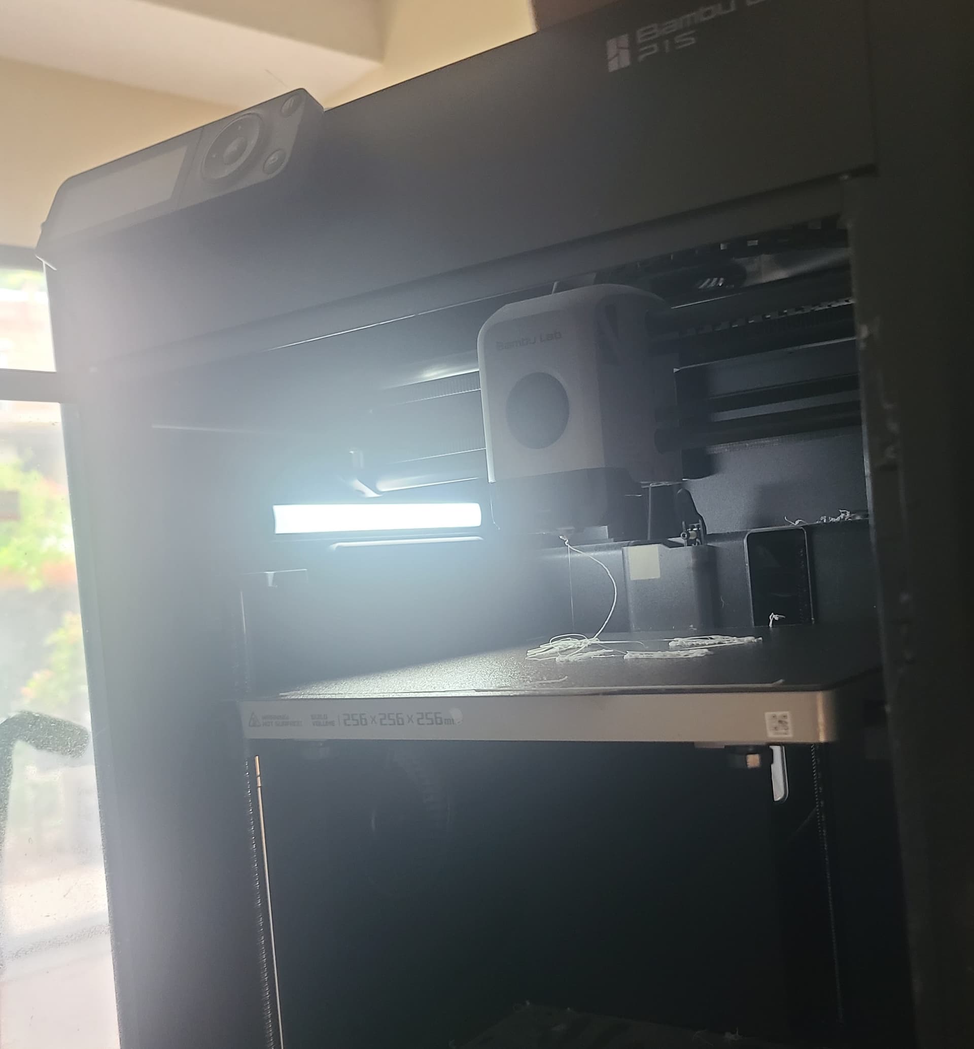

Update…problem still. It appears to not be the AMS. I tried with AMS and manual feeding, 3 filaments, and 2 bed plates (1 is new).
The temperatures seem fine.
Does this mean it’s something in the nozzle unit? Can that explain these results?
Is that the gold plate you are using?
The two passes the nozzle makes across the front of the build plate, does it look as ragged in real life as it does in the picture?
You have run the auto calibration and it passes or does it hang at some percentage complete value?
Do you have a spare nozzle that you have not used yet?
Solved! Apparenly my last print before errors came up was really stuck and I had to use force to get it off, and in so doing, I guess the build plate moved. Is the mis-alignment on the top build plate or on its supporting structure bed?
