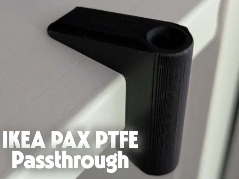

For the drag on the AMS-HT, I used this :
Maybe you could adujst and fit it for your need ?
My need was from one shelf to the other underneath. Once I put my original tubes into this, it’s not moving anymore and the TPU go right throught it without problem.
