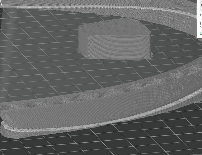

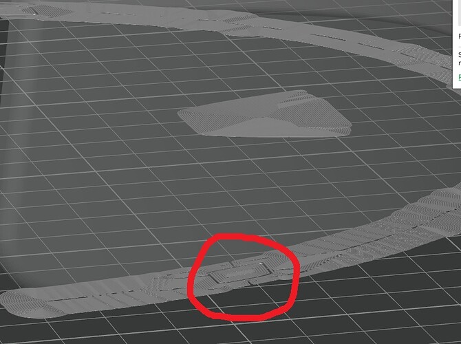

Hello. I have a model where a part of the underside surface is touching the plate and the rest of it is on support. I was wondering if there is a way to lift the model one layer so that part also is above the support.
Not directly with the move tools, but you can add a “Raft” on your support settings. This will print a small plastic base upon which the rest of the model will always lie on. Check the preview
