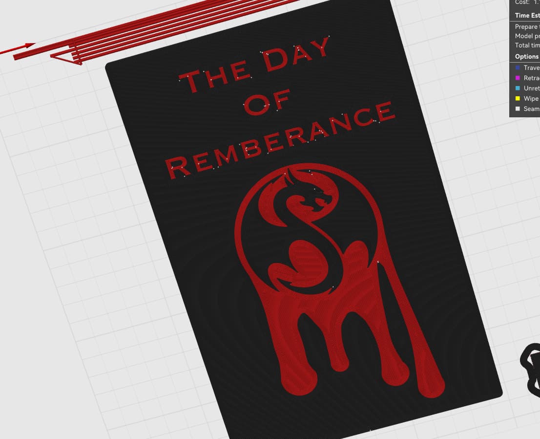

i am trying to print a step file, created in Fusion. i have have done this in the past with no issues. i updated to 2.3.1.51 now it works selectively
now when i choose my colors in bambu studio it will show exactly what i want to come out, but when i slice it, it will randomly not print the color as shown in the preview, this is maddening because it shows up properly in the preview.
it’s mostly text that does this.
i am printing flat objects, on their face, like coasters and book marks.
it worked in the past with no issue. and i don’t know how to revert to a lower copy of bambu studio. sorry luddite

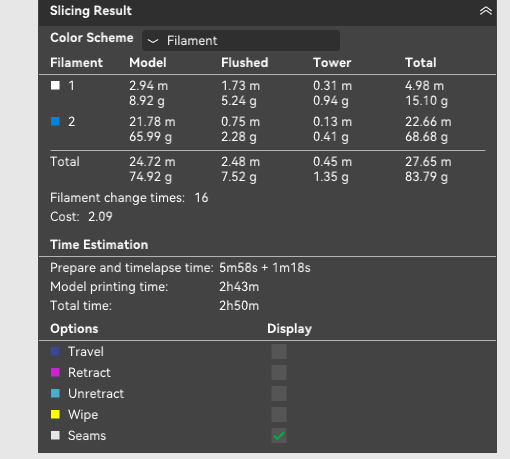

Are you looking at it in the filament tab in the preview?
So, the only thing we really know is that the print is not what you expected. There are too many things we do NOT know about your project to provide any help. Provide a .3mf project file that is not working and maybe we can suggest some changes.

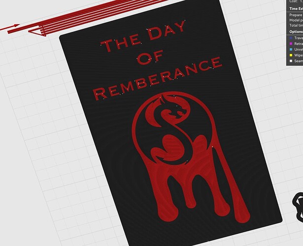

the day of remberance cover _Fixed.3mf (729.1 KB)
Try this. It is easier to make the text a modifier with a different filament color than having them as multiple parts. You can import the same, just right click on the component > change type > Modifier.

thank you so much, still don’t know how that worked but it did. and yes i corrected the spelling
