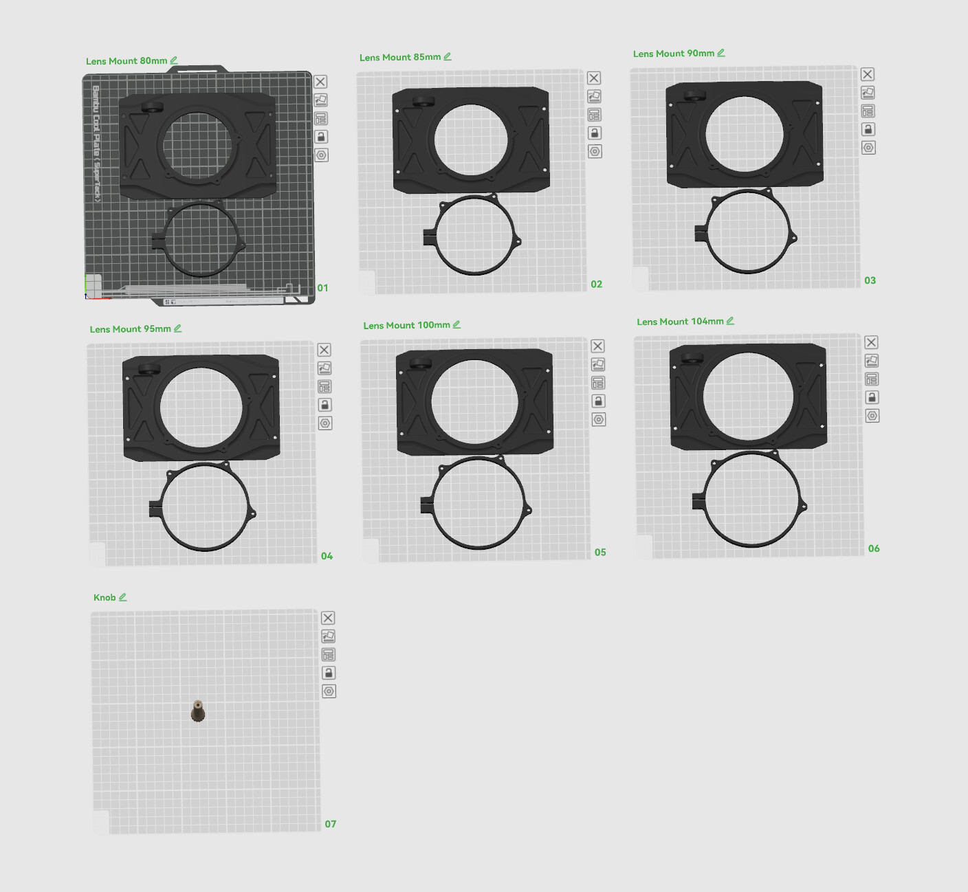

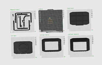

I’m breaking my next couple of projects up into multiple print profiles. Although, I have reasons.
For my crane, everything is just, there’s so many parts. So I’m breaking it up into main sections which the build instructions will follow along with. (There’s more print profiles, for the boom tip, boom base, 40ft boom, 20ft boom, and hook blocks.)
I’m doing that with my matte box too. There’s the main body, the lens mount backs, and the filter trays.
To me it makes sense to break things up some like this. I guess still within I’m not like giving a print profile for each filter tray type, but each profile profile is suppose to encompass a sub-section of the overall project, with the goal of helping the end user focus on one section at a time. Particularly with like the crane, which is a lot of parts. By breaking things down a little further, I’m hoping to help keep things organized. For myself and others! Like if I want to print another 40ft boom section, I just load up the 40ft boom profile and boom, there I go.
Alright, well, that’s not the same as what that guy was doing with that snail, haha. There’s no reason to have the snail/slug and shell seperated. I do think there are times though when a breakup of the print profile isn’t such a negative.
I guess the other point is, very large print profiles can bog the system down a bit when uploading to Makerworld, can time out, fail, whatever. It’s rare, but it happens… haha. Actually I haven’t seen that happen lately, so maybe they’ve improved things.
(edit to add) I hope my approach is fine here. I’ve gone back and forth a little on it, how I want to handle it. This post got me commenting because it’s a topic that’s been on my mind. Like I don’t think I’m falling to the issues that Qjo is stating, but I’m also in my own little world over here, so. :man_shrugging:
