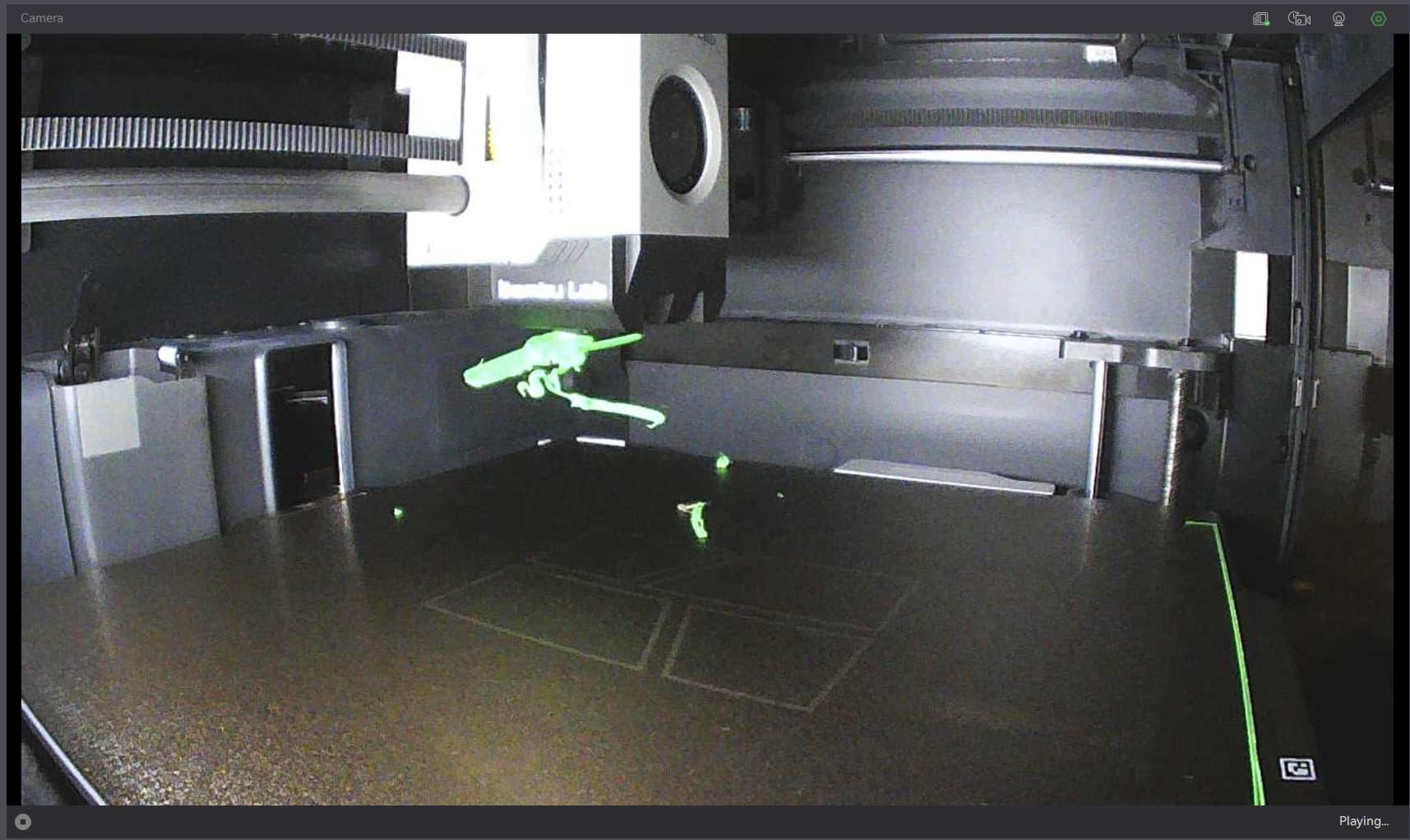

This image attached was printing Bambu Lab PETG-HF trying to print this model using the designer provided print profile.
I was trying to print this with a Bambu Smooth PEI plate using Bambu’s glue applied to the print area.
Nozzle: Stock (Stainless Steel 0.4mm)
Below is a screenshot of the PETG nozzle settings.
While adhesion normally points to increasing bed temps, I’m hesitant to do so as I’m under the impression that everything on the printer is calibrated for everything Bambu, and things have been fine up until yesterday/day before where nothing has changed.
However, I performed a factory reset when things started going wrong which seems to of done the trick mostly. I also set Bambu Studioo back to default by deleting the local folder in AppData, just so there was no confliction.

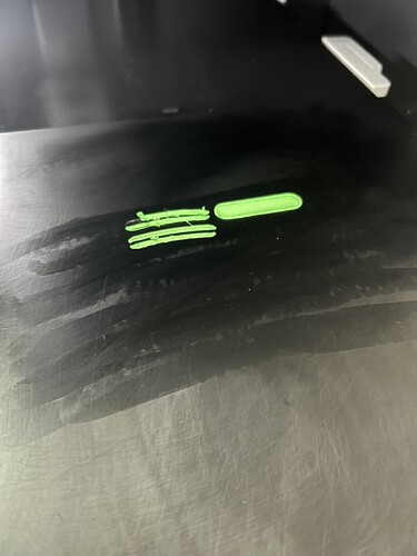

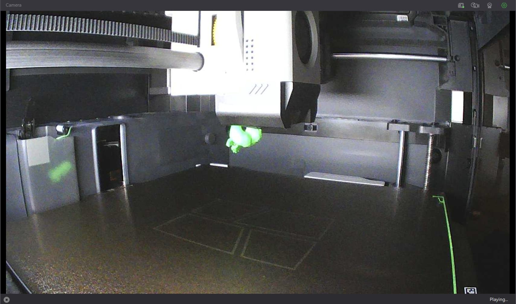

While I’ve typed this up, I’ve tried printing on a Textured PEI plate (making sure to swap in Bambu Studio) where the PETG just got stuck to the nozzle, pictured below plus aftermath.
Has anyone got any ideas why my printer has thrown a wobbler so suddenly? I thought perhaps consumable degredation, but I can’t see 3 different plates struggling with adhesion issues and the nozzle struggling after 315 hours of printing.

So for the textured plate, I use 99.9% IPA in between prints and normally use a sponge and Fairy liquid washing up detergent for deep cleaning. When I started experiencing problems, I did buy some 0000 steel wool and took it to the plate to roughen it up a bit which seemed to of worked. As I type this, I’m currently doing a calibration cube to reconfirm that.
For the Smooth PEI plate, normally just a sponge and you guessed it, Fairy liquid. I normally wash both plates after about 5-8 prints on each. This is also using hot running water. I actually used the rough side of the sponge to see if that would do anything, and it basically just put fine scratches in the plate which doesn’t seem to show up on the print.

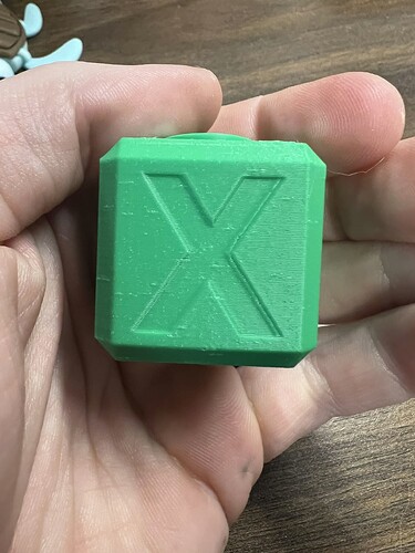

Regarding the callibration cube… :sweat_smile:
It sounds like your cleaning routine is just fine. Normally my second guess would be damp filament and the third guess would be partial nozzle clog. But if the filament has been fine up until recently I’m thinking nozzle clog. Do you have the spare nozzle that came with the printer to test that theory out?
So just on this note, I thought to myself… How often do I actually clean my plates?

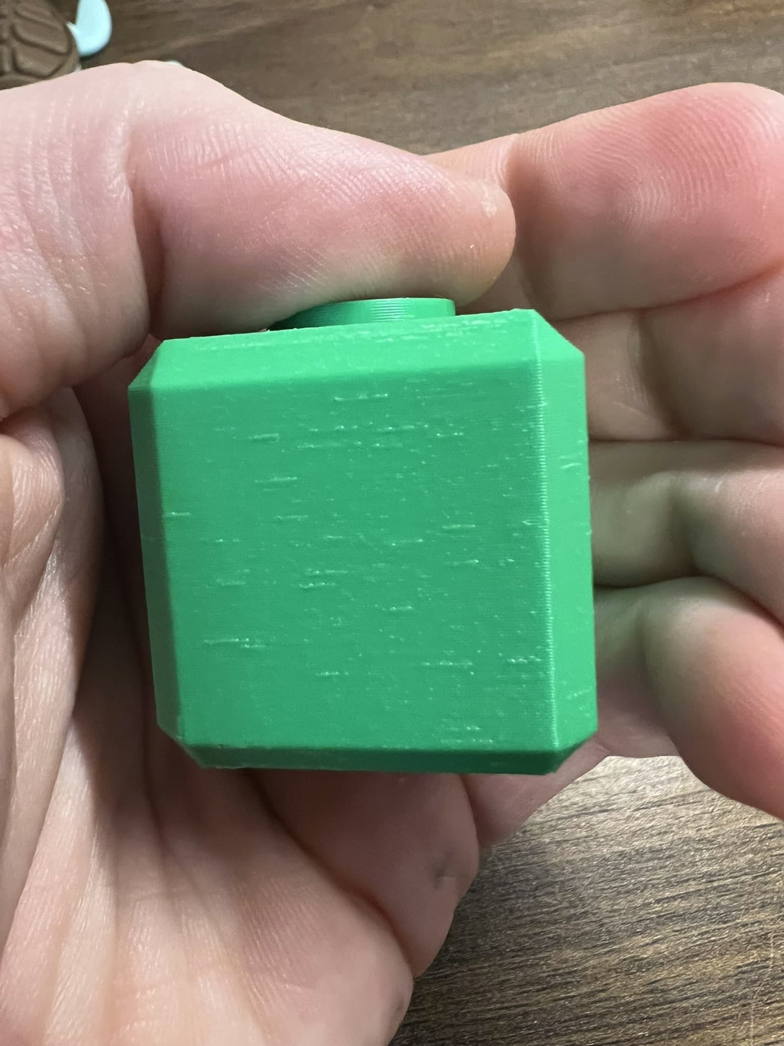

So! For anyone scouring the internet for answers in the future, the initial layer adhesion was simply down to possibly poor cleaning… somehow. As you can see, the cube printed first time after re-cleaning the plates. It’s possible that the 99.9% IPA was causing an issue with adhesion.

I’ll be trying this next as, per the images, there’s some artificing on the layers which could be due to the partial clog, unless you can tell me otherwise. It’s almost as if there’s layer shift, though I don’t think that’s the issue.

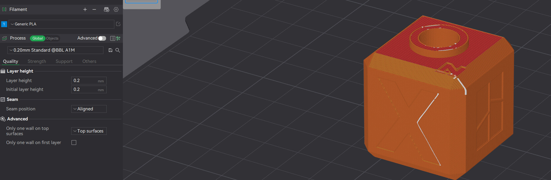

You’re welcome, happy to help! Before you swap the nozzle tell me one thing, what is the “seam” setting in Bambu Slicer?
Oh and I was going to mention the IPA but when I saw you said you used Fairy Liquid I thought it would be enough to cancel out the IPA. I know a lot of people swear by it (IPA) but I’ve never had much luck with it.
Because I was fixated on getting the first layer to adhere to the plate, I actually didn’t check the settings.
Ignore the other settings as I haven’t set it up for PETG, but upon initial opening of a new download, the seam is set to ‘Aligned’ as seen here:
Good thought process though!
So that’s good then. So damp filament or partial clog. If you have a filament dryer that might be easier to test before swapping the nozzle.

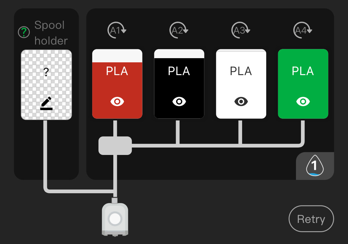

I have desiccant pods that are rechargeable in the AMS. The moisture level in the AMS is 1.
I’ll look into a filament dryer. Thanks.

Hey @kraxous, that really looks like “wet” filament to me too. PETG HF is very sensitive to water and I’ve had spools print poorly right out of the shipping bag.
Water in the filament causes pressure spikes in the extruder and forces out excess filament in places. That’s those little scars on the surface of the cube you see.
Something else about PETG HF is it seems to get sticky when there’s water issues or just likes to curl instead of leaving the extruder cleanly. That is what causes those buildups on the extruder and it can encase the extruder, force the cover off, and wreak all sorts of havoc. There’s a bunch of photos here of extruders hidden in balls of extruded filament and it’s hard to clean off when it gets like that.
Here’s an older example from my own printer - 1st image is a print of some clips that shows lifting in corners, a doughy surface, and a few of those little scars. The second image is the same print and settings but using the same spool of filament after drying.
