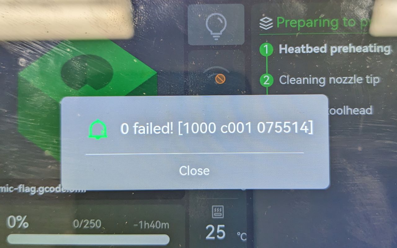

Hello,
Got a strange error while in the preparation stage of the print:
0 failed! [1000 c001 075514]
At first it came up with the Retry/Done/Cancel dialog, I chose done and the prin kept going. I had to cancel the print shortly afterwards due to wrong build plate in the file but when I corrected it and started the updated print, the error came back. Searching the forum and googling didn’t seem to bring much up. The Bamboo error wiki closest error is:
1000-C001 (1000C001) High bed temperature may lead to filament clogging in the nozzle. Please ensure ventilation for the printer.
Doesn’t seem to be very applicable? Any thoughts?
I started seeing this error when I switched from the Cool Plate (@ 0-35°C) to the PEI plates (@55-70°C).
Bambu recommends door open and/or top off for PLA, PETG and TPU to prevent heat creep.
The X1 has sensor to detect when the door is closed.
If I remember to leave the door open for PLA and PETG I do not receive the error.
The only clog I ever had occurred when using PLA-CF with a closed door.
I thought about this for a long time. Never entered my mind that the door was being watched. :laughing:
It took me a long time to make the connection between the error and the door. The error really needs a more explicit description.
