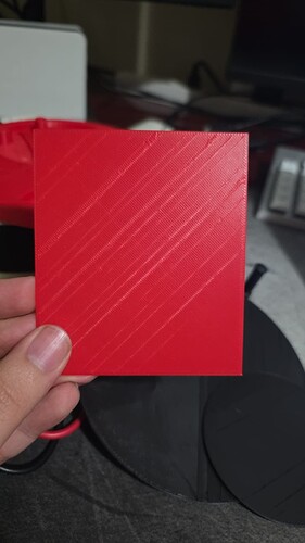

I’m having problems with my P1S and I hope you can help me identify the cause.
I’m not sure whether to call the problem underextrusion or a partial clog. Recently, I started getting poor finishes on the top layers.
Since I was doing a multi-color print, I thought the nozzle might be dirty, so I replaced the entire hotend, but the problem persisted. After doing more tests, I realized that the imperfections in the top layers were due to missing lines in the previous layer.
At first, I thought it was an extruder issue. I checked the gearing but didn’t find anything unusual. I ran tests without the AMS and then without the PTFE tube, but the results were the same. Finally, I tried printing at 250°C instead of the default 220°C, and then the layers printed correctly.
While all this was happening, I was researching and found a similar problem where the solution was to replace the extruder board. So I bought a replacement and installed it, but the result is still the same. I hope someone sees this and can help me diagnose the source of the problem.
So far, this is what I’ve done:
  • Check gear Extruder (everything looks in order)
  • Test feeding without AMS
  • Feed directly without PTFE tubing
  • Replace hotend
  • Complete recalibration
  • Reformat microSD card
  • Replace extruder controller board and recalibrate
  • Check extruder motor
  • Replace hotend thermistor
For all the above tests, Bamboo PLA was used. It was tested with a recently purchased, new spool, and the default profile for Bamboo PLA was also used.
The fact that it works by raising the temperature makes me think it’s an electronics issue, as if the reported temperature isn’t the actual temperature. For this reason, I also changed the hotend thermistor with no luck.
I tried measuring the nozzle temperature using a multimeter, but the difference is more than 30 degrees (220 on the printer, 185 on the multimeter). I performed the same test with my A1, and the difference was 20 (220 on the printer, 200 on the multimeter).
I tried slicing with Bambustudio in its latest version as well as with OrcaSlicer
Thanks in advance for any help!

I suggest that you perform a full clean and lube maintenance, and then recalibrate the printer. That corrected a problem I had, which was very similar to the top picture.

The first layer prints fine because it prints at a speed of 90, if I remember correctly, but when the speed increases to 210 for subsequent layers, the problem arises at 220°C. I’ve tried lowering the speed to 120-150 with a generic PLA, but the result is the same. If I raise the temperature to 250°C, then it prints normally.

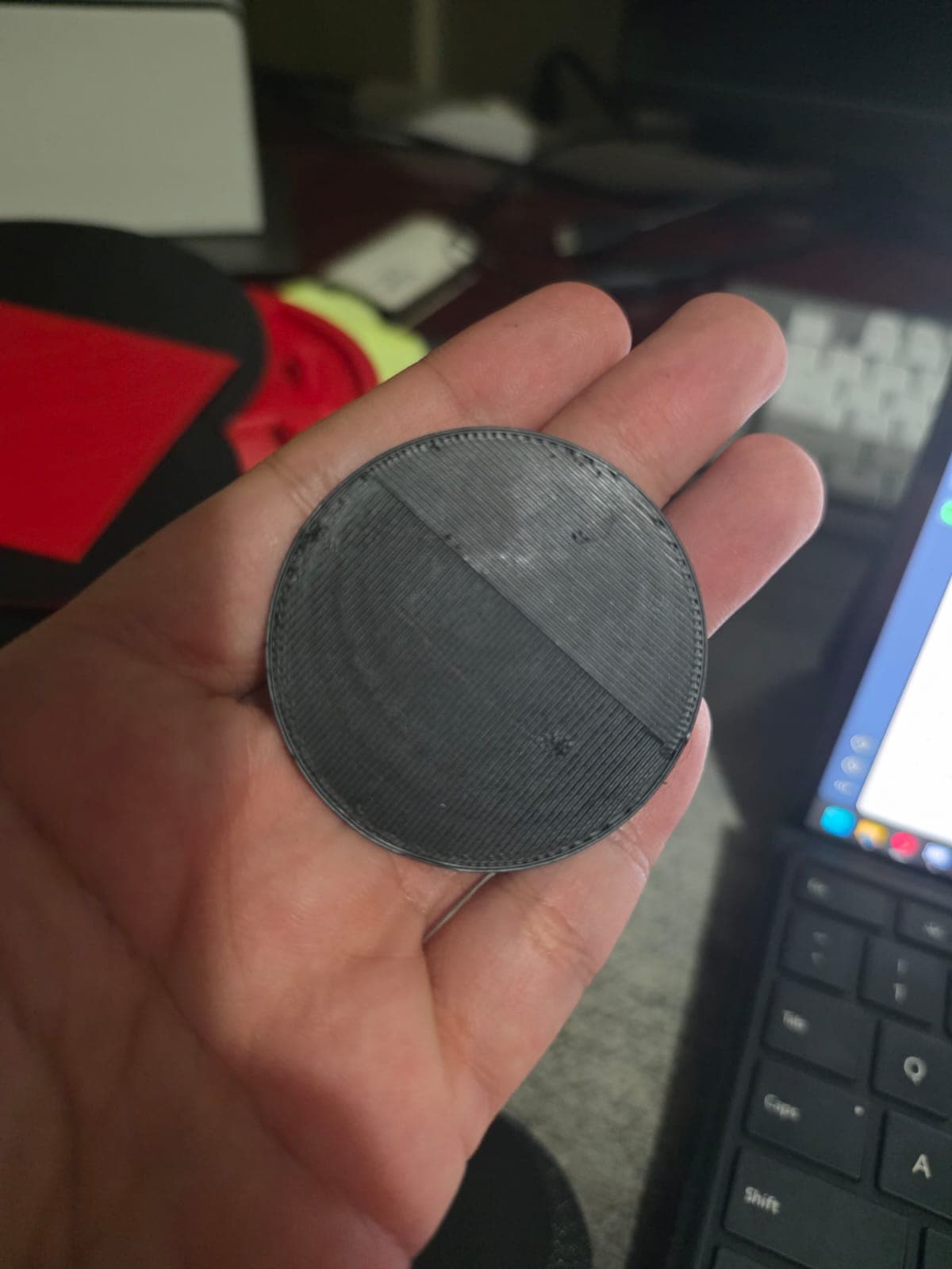

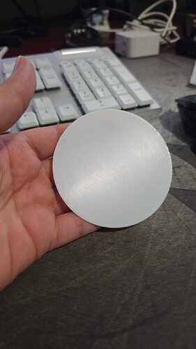

I’m still having the same problem. I hadn’t posted an update because the last thing I changed was the cable connecting the two extruder boards, and it took me a while to make the change, and surprise, surprise, there was no change.
However, I noticed something interesting that makes me think the problem is with the motor. I did this print after the printer had been off all night,
and as you can see, it’s almost perfect. This other print was done 15 or 20 minutes later,
and you can see the result. This makes me think that the problem appears when the printer heats up, so to speak, and in fact, I’ve repeated this test twice, and the result is the same.
Seeing that when I lower the volumetric speed to 12, for example, I can print correctly makes me think the motor doesn’t have enough power to push the PLA at 21 mm/s.
I’ve also ruled out a temperature issue since, as I said before, the print completes well at lower speeds, and the first print, when the machine is cold, also worked fine. It prints correctly, perhaps the motor starts having problems and skipping steps after extended use. I’ve also tried observing the gear and it seems to me that there are times when it doesn’t rotate, but I’m not sure because of the toolhead’s rapid movement. Currently, the extruder motor for the P1s is out of stock at the store; I’ll see if I can get one and test it.
