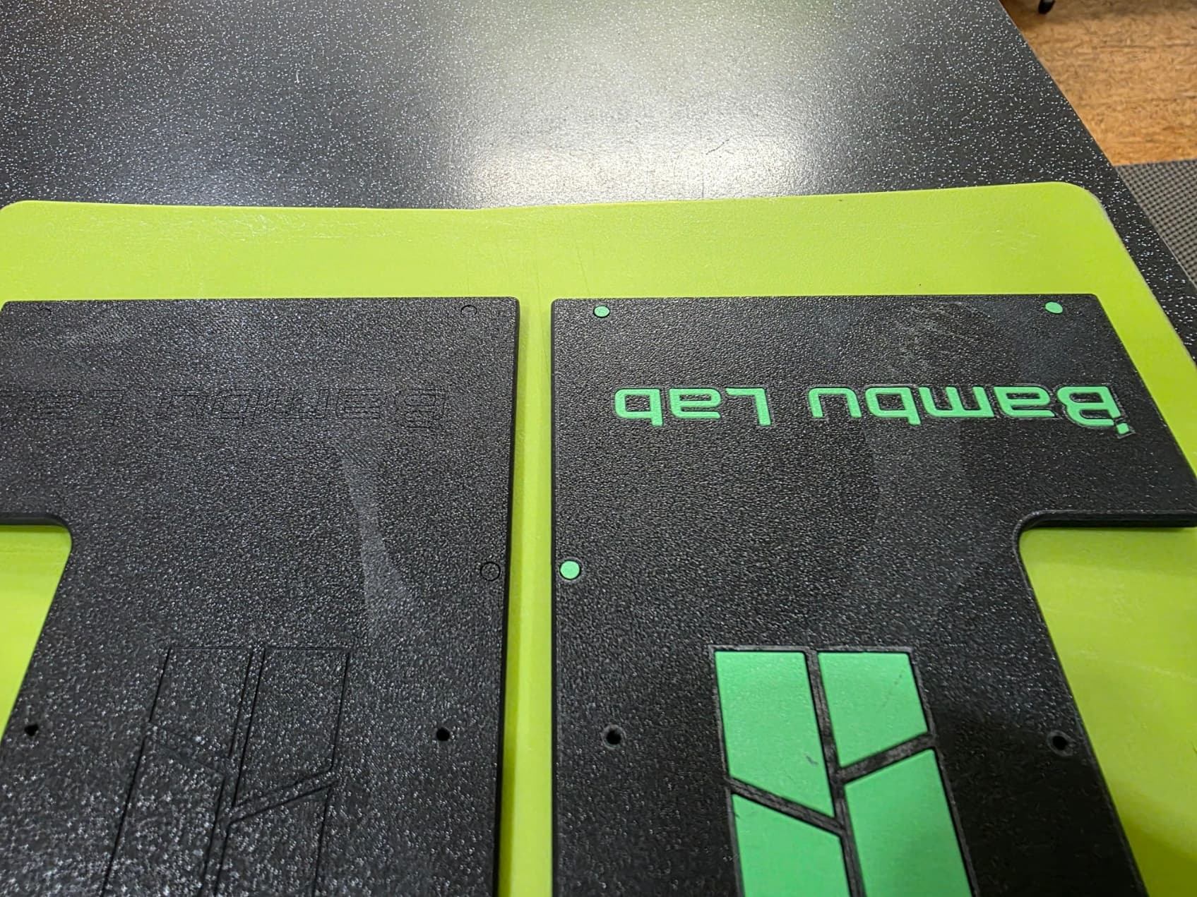

Hello,
printing with my new P1S has with PLA Matte filament a weird effect:
From the Logo to the Text (specifically ‘mb’) there’s a white transparent “veil” on the surface, also below the text - the same applies to the left part. The white effects are not reflections of the light. They are embedded in the material - not detectable by touch. The surface feels perfectly homogenous.
I let the plate cool down entirely before removing the parts.
The plate is new, the original one delivered with the printer, I have cleaned it thoroughly with isopropanol - to no avail.
Setup
P1S / AMS 2 Pro
Bambu Lab PLA Matte Filaments
Bambu Studio with default values for the filaments
This happens with all prints - not with specific ones.
Does anybody know where this could be coming from/what I’m doing wrong?
If you search the forum for “stress marks” you’ll find a ton of threads about it. Depending on the build plate and the filament it’s really hard to avoid at times. The most recommended solution is a heat gun or other heat source. Be careful to not deform the part in the process. Usually people will also recommend letting the part cool on the plate but I see you’ve already tried that. Here’s a vid:
