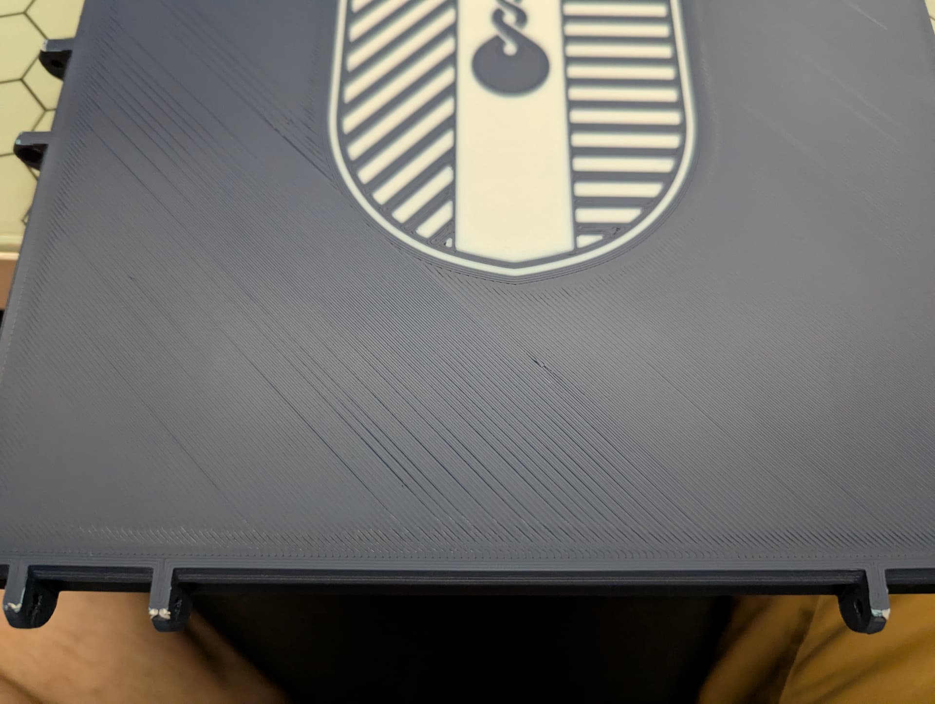

I have streaks in my first smooth layer on my print (dark blue matte PLA)
I haven’t changed my settings from previous prints, so I question how best to solve it. Is it only a slowing down?
Also, I don’t know if it’s linked but I also see streaks where the hotend scraped a surface, see lighter colour lines here.
This looks like under extrusion to me. Have you run the calibration process?
Yes. And nothing was amiss
This definitely seems like under extrusion. Calibration is not always foolproof. Size of the surface area is very much a factor. A Flow Rate that looks good in a small area may not be as good for a significantly larger one.
I would run some tests with surface areas approximating the size you have here and adjusting flow rate between them at 0.01 steps.
I bet you will find one that yields the best result and it will be different from the one you get from calibration.
