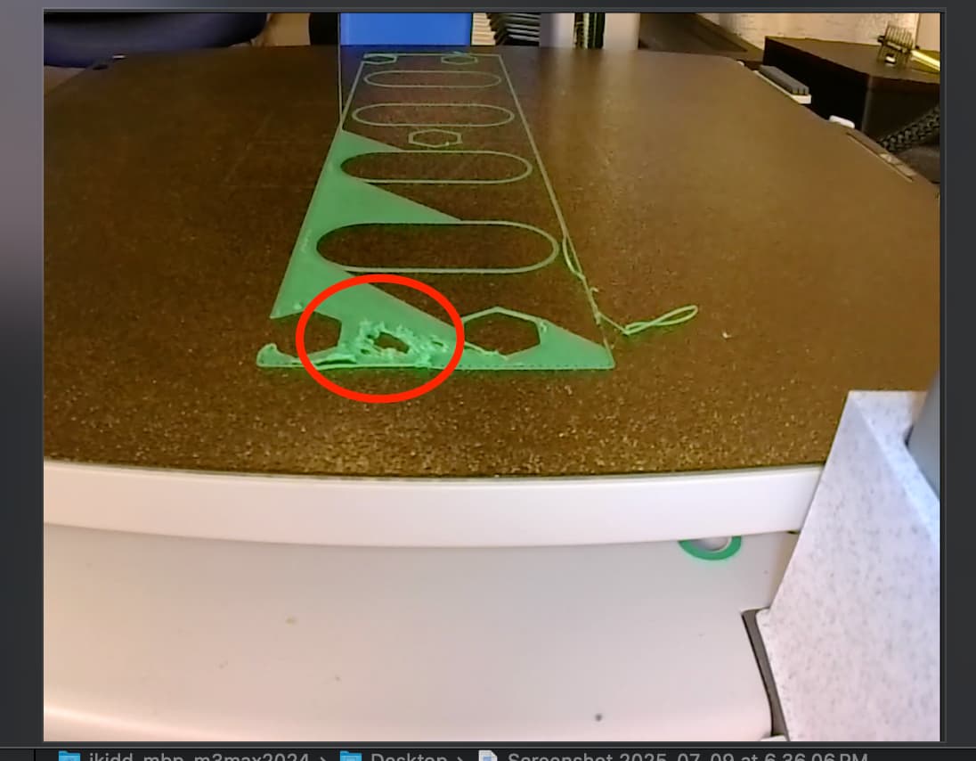

Stringing in same location no matter what
this is bambu’s PETG HF and it was printing fine for a day or two. It’s been dried, I’ve tried different settings and it seems as if this location and one other one always cause issues with balling up the filament. Can someone please help. It’s strange that it was fine for a couple of days, then this issue now. I thought it may be the build plate, but rotating the model still causes issues in the same location.
:frowning:
Sounds/looks like a finger print on the build plate. Avoid touching the plate with bare hands if you can. If you wash it with warm water and dish soap (degreasing) it should resolve the issue.
