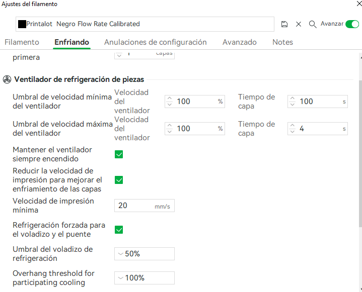

Hello everyone. I’m having trouble with the black filament. I’ve run retraction tests and I don’t have any threads, but when I print, the prints come out blotchy. I don’t understand what the problem could be. I don’t know what else to do. I changed the filament profile with a retraction of 1.4 and a z-step of 0.6, and a temperature of 200 or less, and I’m still having problems. Filaments from different brands and new ones; it’s not a humidity issue. They used to work fine, but then they started failing. I’m thinking it could be a firmware update for the printer or an update to the Bambu Studio. Could someone please give me some guidance? Thank you very much.

I also lowered the fan speeds.

Hi everyone. I’ve been running a lot of tests, and even though the K factor was 0.2 to 0.25, I kept increasing it to 0.4 and managed to get it to run smoothly. I don’t think I could have done that because I was guided by what I saw in the printer calibration tests, but I got it to work. Thanks so much for the help. I wanted to share my experience in case it helps someone.
I had a similar problem with PLA basic and I also posted a Ticket, but they guided me to calibrate the filament from the WIKI. I tried a lot but finally I managed to set K to 0.02 and everything works ok. One small note: for EU use decimal separator dot instead of comma. Very similar problem with MS Excel decimal separator.
