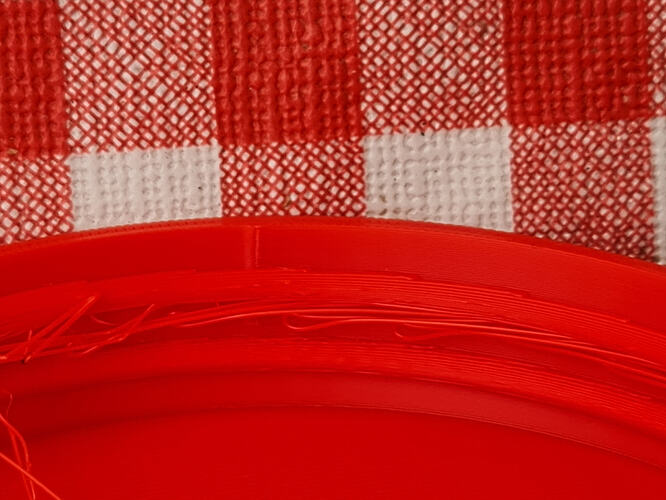

I am new to this and I am hoping for some help. I designed and printed my jar lid and i get the strings? in the upper layers (last 7mm not the base and first 7mm) see attached pics. Using a p2s and bambu pla basic filament, 0.4 nozzel , default printer settings, have done filament drying.
I am not sure where to start. What do your call this defect, and where do i start / look at to fix it. It looks like the feed has hooked back on itself, seems only to effect the thread protusion not the body.

Printing threads can be difficult. The combination of overhangs on the threaded section and that the feature is an internal radius is what’s causing the stringing issue. Printing interior round features is harder because the outside wall of the thread doesn’t have anything to support or bridge between. If the outer thread wall fails early it will compound the issues as the thread forms.
Depending on the thread, lowering the layer height at this feature can help with the overhang issue.

By layer height I’m referring the the amount the slicer instructs the printer to lift the print head each pass. Tall layer heights print parts faster while shorter layer heights complet the print slower but with more detail.

Changed the layer height in bambu studio (went high quality) as suggested and it pretty much eliminated the issue. There was a little stringing down low but I think that was in the initial coarser step base layers.
