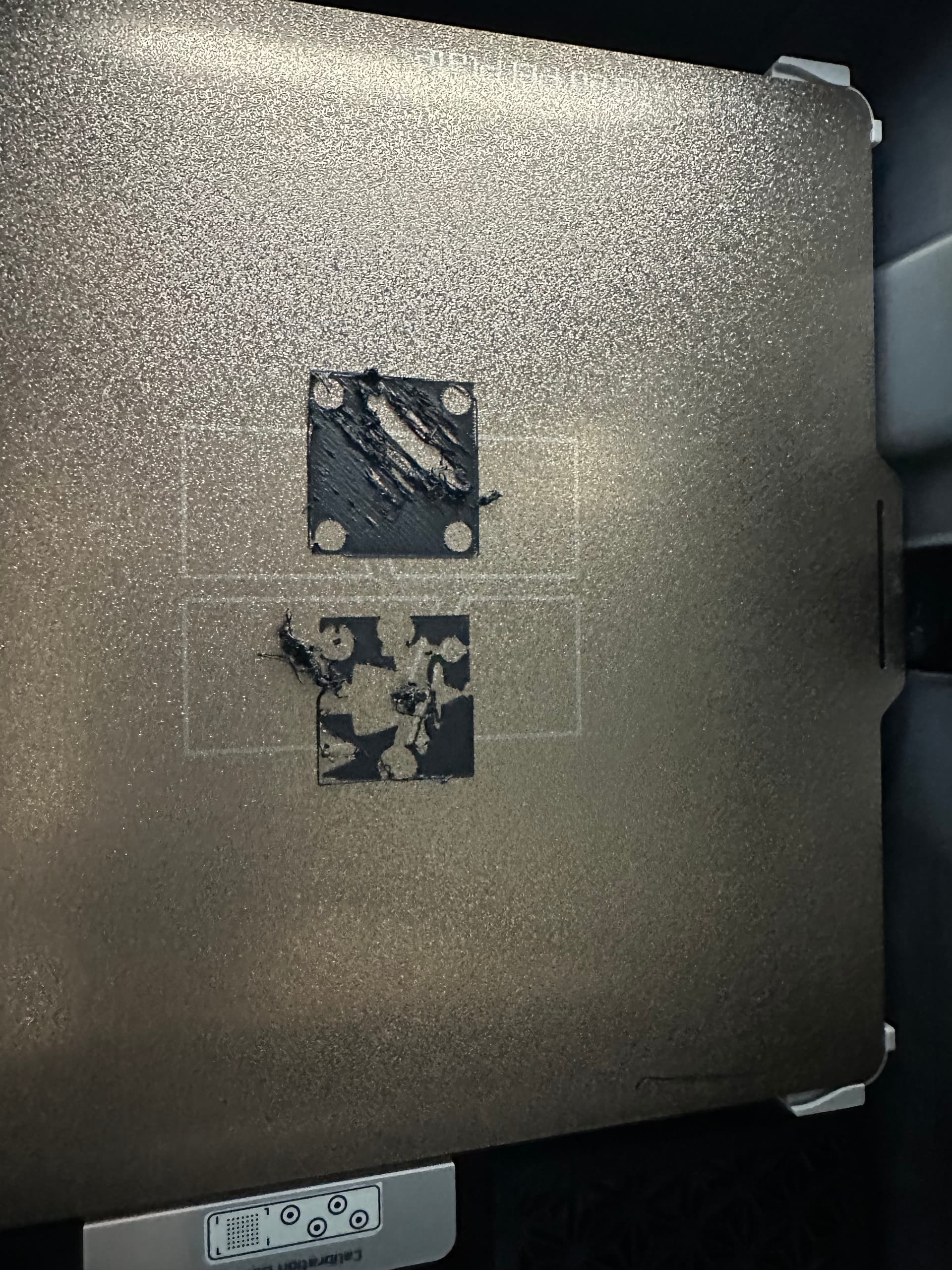

I had a print with PLA-CF that needed to be done so I started the print. Got first layer issue from the printer and the material didn’t stick to the bed. Ok… Grab plate go wash with hot water and Dawn dish soap and retry. Same results. Hmm. This is a part I print pretty often.

Regular PLA seems fine now, but PLA-CF still won’t adhere to the build plate. Tried raising the temp of the PEI plate to 60*, same issue. It is like it is not being smooshed into the plate at all. However the line it prints on the edge of the plate is fine.

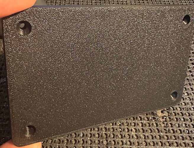

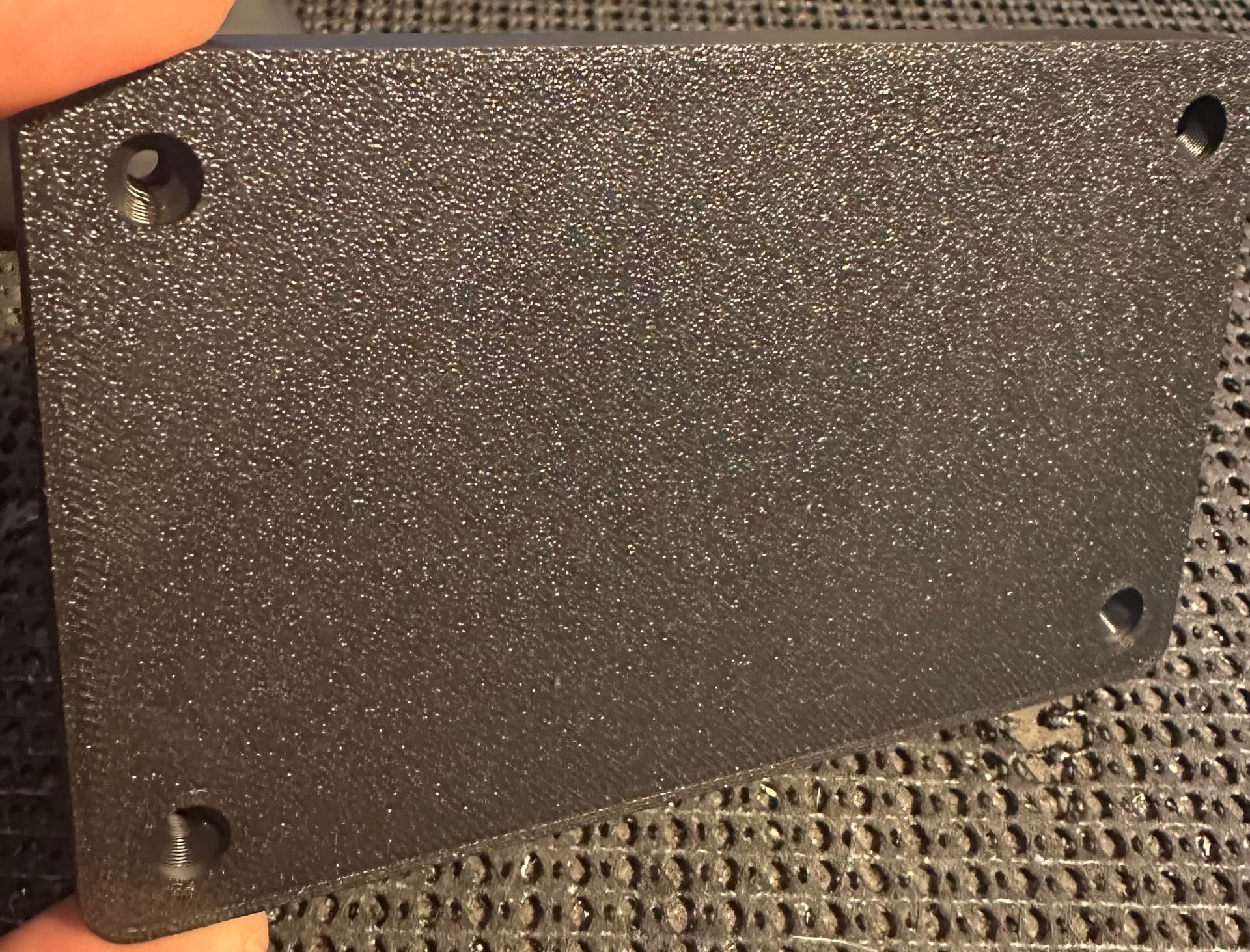

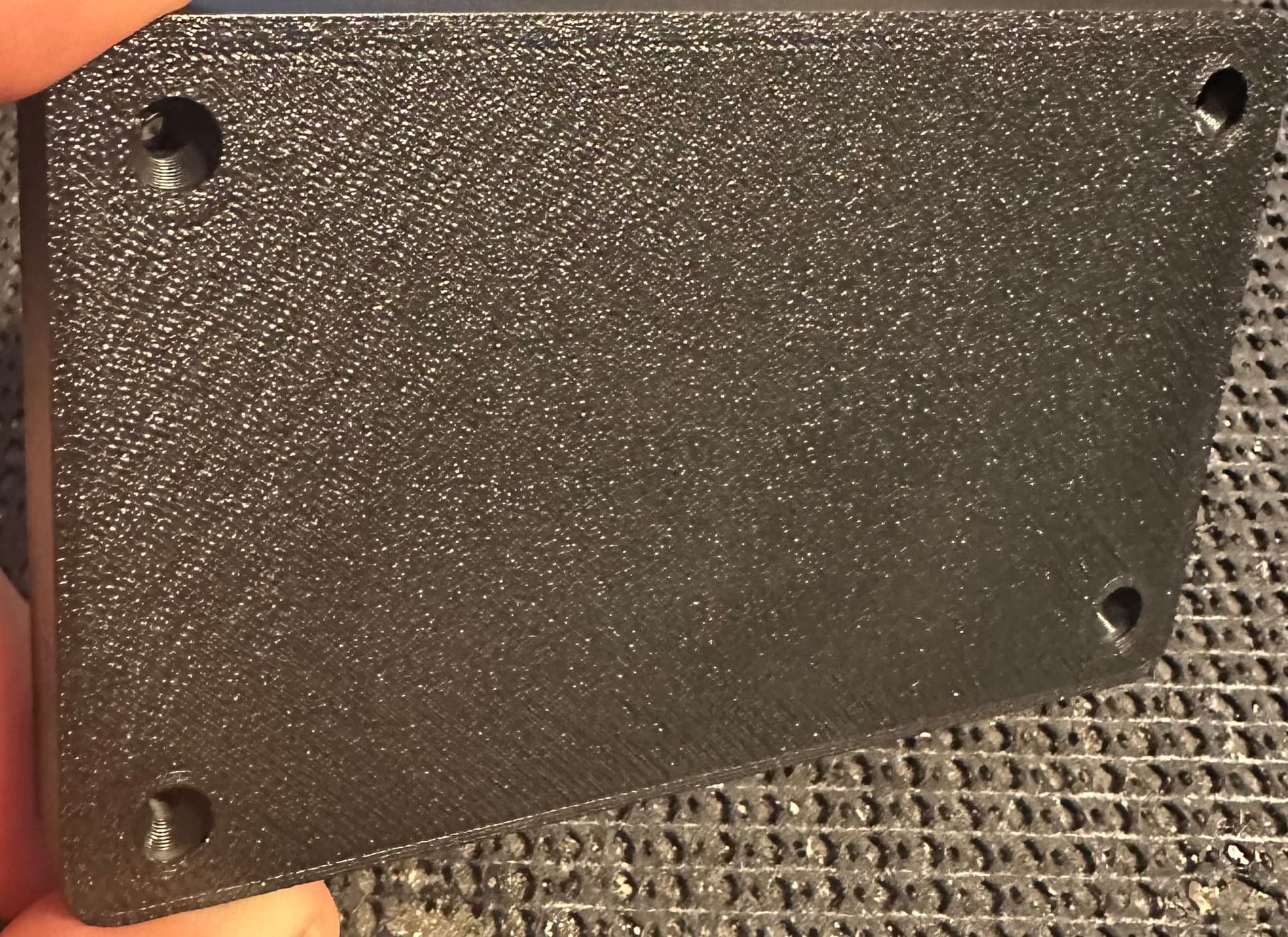

Here is a before and after pic of the PLA, which seems fine now.
But still PLA-CF issues.
