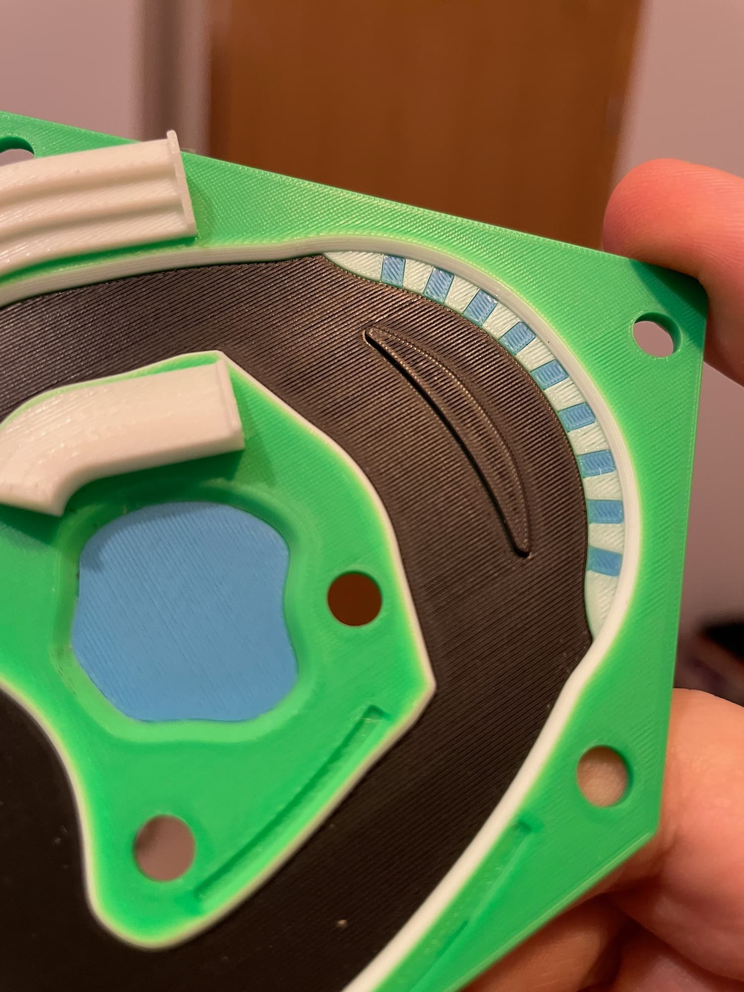

The default profile has ironing enabled. At first I printed the gear and the base. The gear came out very good with a very smooth surface (default ironing settings). The base also looked good, except for a part where it is very thing (6 or 7 layers)
Then I printed the top part - the result was terrible (see attached photo). What I find strange is that most of the black parts look terrible except for the one that is higher? Btw. all filaments used were Bambu PLA Basic.

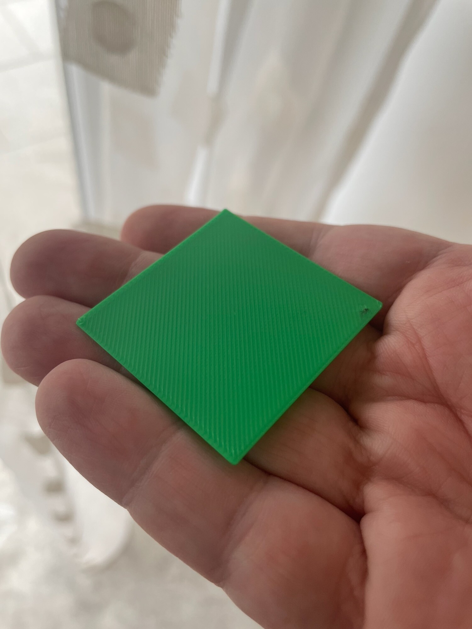

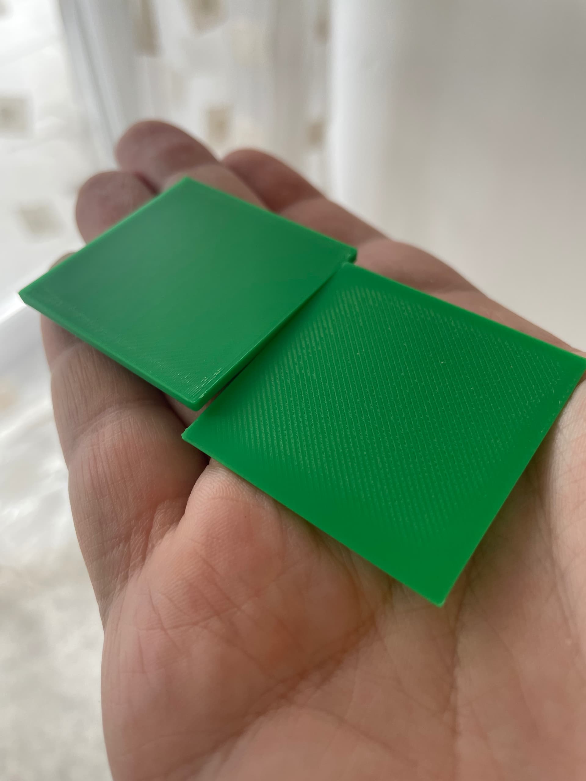

There were several good looking squares, I choose 15% flow and 20 mm/s speed. Then I printed a small square (40x40x0.6) with these settings and the result was again terrible. Of course the calibration model is way thicker, so I did another print of a small square (40x40x2) with the same settings and it came out good (see the other attached photo).

I’m afraid I won’t be able to increase the top shell layers since the model is only three layers high at its thinnest part. So I guess it could also be a thermal issues - maybe the surface is just too hot since it’s also close to the bed.
A thin square without ironing looks pretty consistent (please ignore the black spot, that was some debris).

Hmm, the surface looks normal, but not ideal. It should look much smoother without ironing. It’s not that it’s bad, but it’s not a good foundation for starting ironing. On the other hand, even Bambu shows the surface like this. You did the calibration according to this tutorial, right?

I wont speak about this in terms of settings, just in terms of physical reality re: your 0.6mm test vs 2.0mm standard test
Take a cross section of that ironing swatch and you’re going to see an infill void area. Do it again on the 0.6mm cube and you’re going to see solid plastic. Ironing is sensitive to how uniform the top surface is to begin with, and a top being built over infill is going to be different than one that is only 3 layers tall and maybe oversqueezed from the “unmovable brick wall” that is the buildplate. If you’ve ever printed something with 1-3 top layers instead of 4+ you’ll know what I mean about the top surface over infill - it sags initially and needs a few more layers to catch up.
tl;dr - if your print has room for infill so should your ironing test, and vice versa

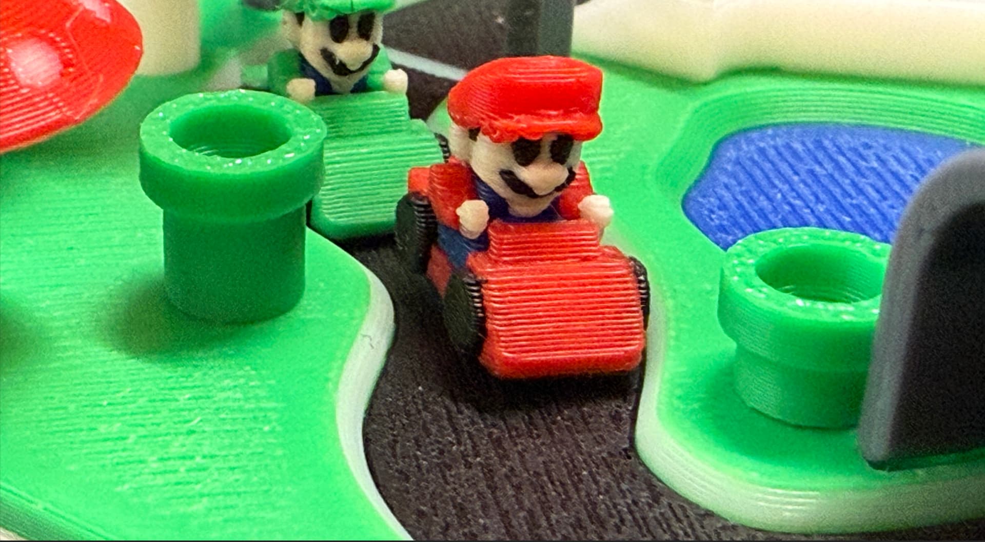

Don’t look at the coin for now, just the surface behind, that’s the difference between 0.2 and 0.4. No ironing.
Yeah some of the other pictures don’t look great either.

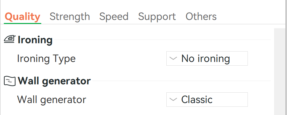

The default profile does have ironing enabled on the object level.
I printed it again with the 0.2 nozzle… it’s better but not great (ironing disabled). I maybe made a mistake and printed with the default flow ratios again since I didn’t want to do the calibration all over for the 0.2 nozzle. Especially the black areas look underextrued to me.

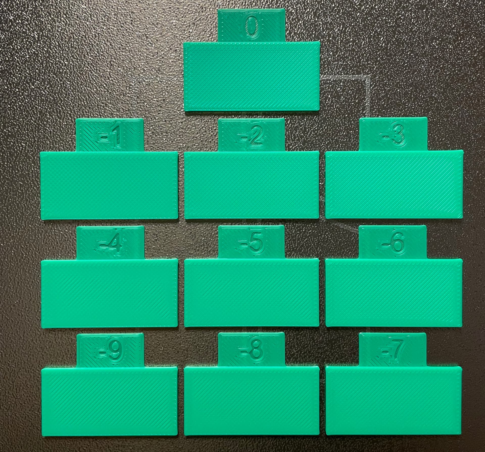

And again, I’m struggling with flow rate calibration. It looks that I need to raise my flow rate for all my Bambu Basic PLA filaments. The wiki says: " If the flow rate value in the Bambu Studio is set too high or too low, overflow or gaps will occur. It is very rare for the filament to require more than a 1.00 flow rate value in the Filament profile. You can do this in Bambu Studio by clicking on “Flow rate” in the “Calibration” page".
Please find attached two photos of a calibration run. I ended up going with the 5 sample in the first pass and endet up sticking with it by choosing the 0 sample in the second pass.
