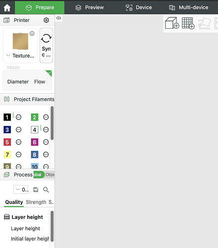

Furthermore, after trying Command + W (reset the layout) and restarted Bambu Studio the sidebar resized to the minimum (see the attached pic) and every time I restart BS, I have to hit Command + W to make it bigger!
Hope they will fix this as I like this new feature too. :frowning:
Edit: solved my “resized to the minimum” issue in MacOS editing the BambuStudio.conf file. Now, while the resizing feature does not work anyway, at least, when I open Bambu Studio, the sidebar is opening as before and not stretched like in the picture.

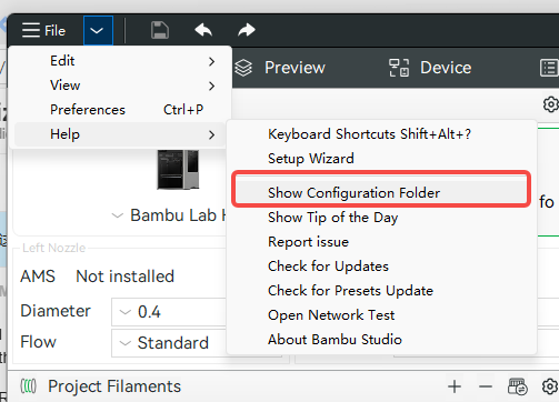

  • Open BambuStudio folder like first picture. Close Studio then.
  • Delete the specific .conf file like above picture then restart Studio.
It should be resizable now,May this can help you.
Hello, please find the help menu, open the configuration folder, delete Bambustudio.conf, and then try restarting the software.

Yes I am on that version. Solved with help of @zhou.xu though just now… method is as follows:
  • Launch Bambu Studio,
  • Select ‘Help’ menu and click on the ‘show configuration folder’,
  • Then close Bambu Studio.
  • Only then should you delete the BambuStudio.conf file from the previously opened folder, and then restart the software again.
Requires re-logging into your account and confirming printers, filament preferences again but you should then have access to the resizable window :slight_smile:
