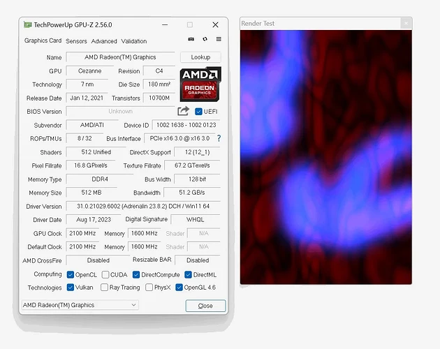

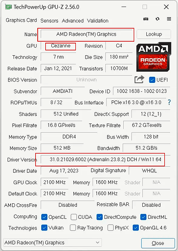

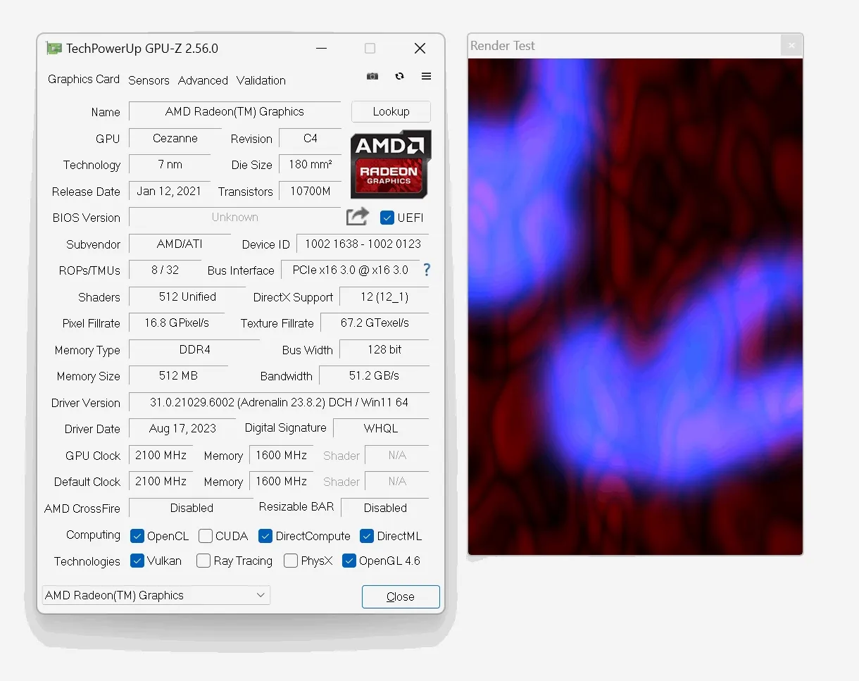

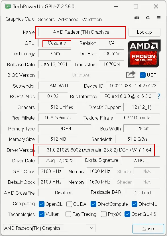

I suggest first identifying the video card and driver currently in your setup. For that, the best tool is the free version of TechPowerUp’s GPU-Z. It’s the big daddy of GPU utilities and tells you everything you need to know.
https://www.techpowerup.com/download/techpowerup-gpu-z/
There are two sites dedicated to graphics cards that host nearly every driver from the last several years, so if the current driver is causing issues, download one that’s a full revision older.
https://www.techpowerup.com/download/ — The authors of GPU-Z
www.guru3d.com Files

So I was hunting around the AMD site and tried thier auto update tool only to download it and be told it doesn’t support my driver please manually download. That led me to the how to find your video card name. I followed and I think I ended up with AMD RADEON Lucienne GPU. Does that sound right or do I need to drill down further.
