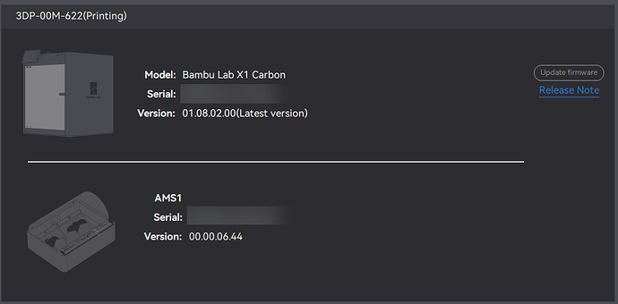

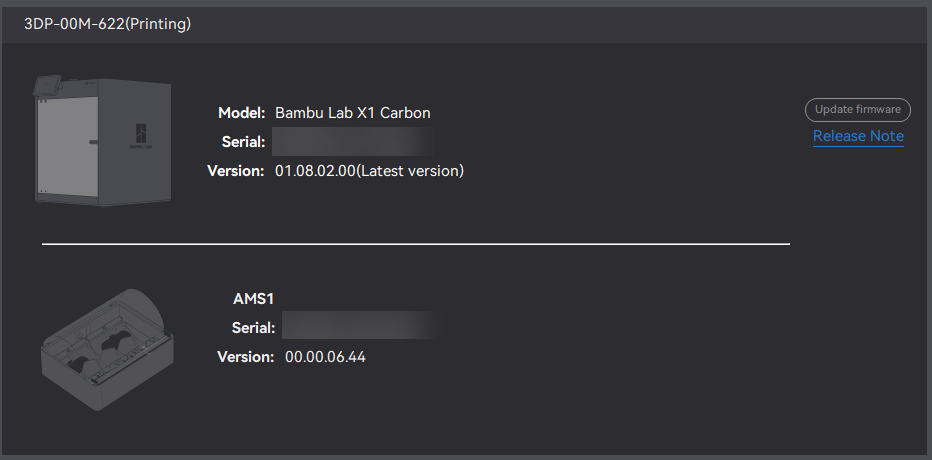

The AMS display shows filament loading wrong. Only the bottom part going into the extruder show the right color. In the image white is loaded not blue. Resizing the window of the program repaints it correctly.
