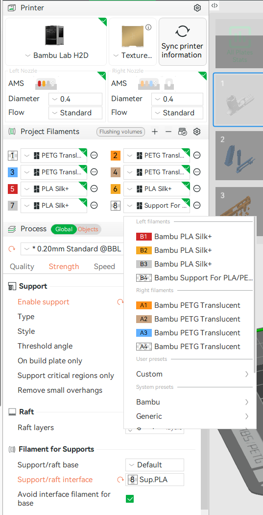

I am going to print using PETG, and I remember I bought some of the PLA/PETG support filament, so I put it in my AMS.
But strangely enough, Studio does recognize it correctly in the project filament as Bambu Support for PLA/PETG… yet under the filament used for supports, it shows up as Support for PLA.
And when I click on the filament slot (placement 8), I also get the correct name:

So of course, Studio gives me a warning because for it its just PLA:
petg
And now I’m stuck — because what’s going to happen if I print? Studio thinks it’s the wrong filament, so it will use the wrong settings.

To be honest, I tried the “Support for PLA/PETG” exactly once. And then abandoned it. Using PETG for PLA and PLA for PETG with a 0mm z-distance and solid interface works much, much better for me.

Well, I couldn’t spot any advantage whatsoever. It stuck to PLA just like PLA.
I then played around a lot with BVOH (which is AMAZING in particular with PLA but does need to be well very dried … weekly … and is relatively expensive) before stumbling upon forum posts on using PETG as an interface layer for PLA and vice versa. Tried it… and never looked back :smiley:
The early days were a bit tricky due to temp settings needing to be just right during the material switch but nowadays, I just hit print.

Since I do not have an H2D, I am not familiar with H2D settings. On my X1, I usually modify the PETG settings to
  • a reduced flow (since it rewards printing slow, usually going down to 75%),
  • check that the fan settings for PETG are identical to the Generic PETG settings (I think there may be a challenge for the H2D as it seems to have a stronger fan),
  • enable wipe on retract and
  • define it as the support interface in the support tab.
  • When prompted to reduce z-distance to 0 I just hit “yes” and print. It has been at least 9 months since I had a problem with that. Probably Studio 01.07. …
