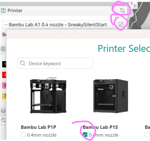

If I start a new project or open a new project, the prepare tab locks up. The software doesn’t fully freeze. I can still edit settings, but can’t touch the plate or any objects. If I go to a different tab and then return to the prepare tab, the last tab still occupies the space where the objects should be and I only the the prepare settings.
I haven’t yet connected a printer… could that be the problem? My new P1S was delivered today and now I’m second guessing if I should even open it.

Originally I thought the answer to this was no… but add one just to see if it fixes it. Just add a vanilla P1S with a .4 nozzle and then try to open the model again.
Not connecting the printer should be fine, but you do need to select and add a printer model. The blank plate renders based off the printer model you have selected. Having a truly empty profile might be in the “garbage in garbage out” category of problems
Add one, any one, but probably a P1s will end up useful for you lol =p
I (think) I’ve got that setup. Already had it, in fact.

Thanks for the screenshot, clarifies the problem. Now I am out of ideas.
