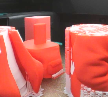

Was wondering if anyone else has experienced this. I am printing in 2 colors. I checked everything or so i thought… My P1S is on a 26 hour print and printing my front words in white instead of red to Match my preview. Does anyone have any idea how this might have happened. The same words are printing correctly in white on the back of the print so that is a winner. The odd thing is the white filament is outlining the outside of where the letters should be. Any help is appreciated.
words on back

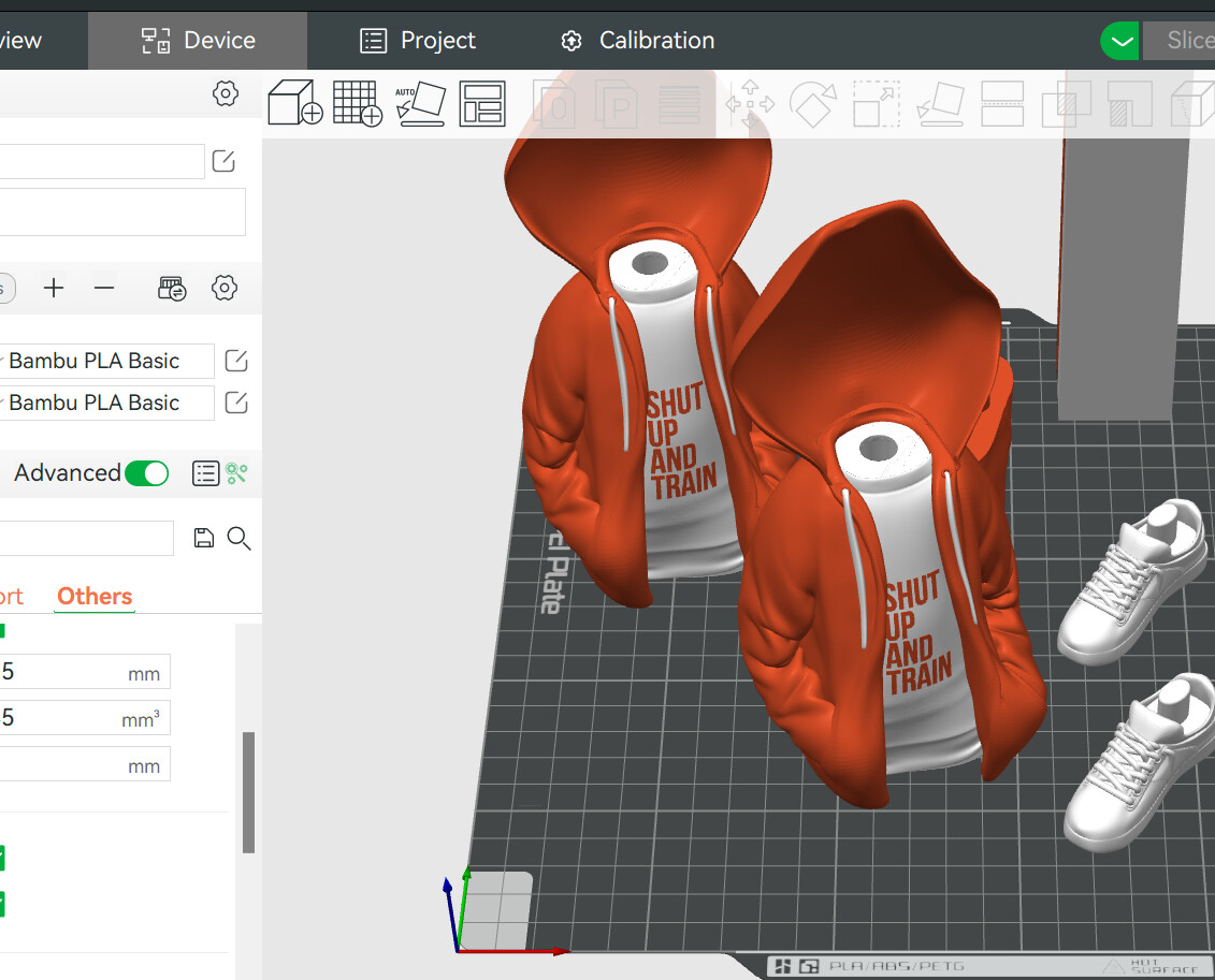

Your screenshot is cut off but here’s my guess:
Since you have 4 colors in the print you have 2 different reds and one of them is routed to the white AMS slot.
Thanks for checking it out. There are only 2 colors in the print and I only have one red spool and one white spool. I had orange and black in the other two slots I believe. I think that it may have been some weird slicer error. My updated slicer has been causing some issues. Thanks for offering your assitance. I really appreciate it!
What does it look like in the preview tab once sliced?
Also, what version?
