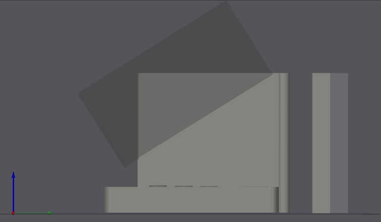

I am stuck trying to design a workstand for an electronic device in Studio because Orca does not yet support the P2S.
Studio really struggles with negative spaces. Sometimes they just vanish.
In the particular example shown here, slicing reorients the negative objects. It also warns me that they need supports, but of course does not actually add any because you don’t support negative space.
I would really prefer to create the shape I want without using cutouts and trying to angle them, but I don’t know if that can be done in studio. All of the shapes seem to be prefab and not modifiable except as to size.

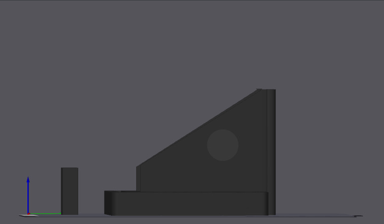

I exported as STL. Bambu Studio offered to do a mesh operations, so I accepted. The STL looked fine - negative objects gone but spaces where they needed to be. I reopened the STL in Studio and it looked fine. Then I tried to slice it.
Another WTF moment.

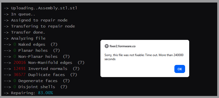

So I tried to export the model as STL again after some attempts to add parts that Studio refused to place where I wanted them. Bambu Studio said it needed a mesh operation, so I said OK. Then I got this message:
So I uploaded it to the STL Repair site.
