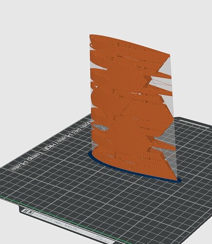

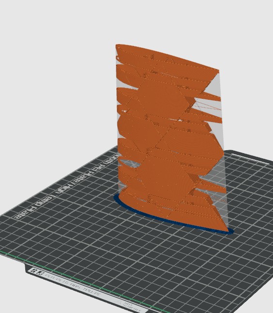

I have a model glider design, the wing sections have all been sliced in Cura and printed on a Creality printed in surface mode (spiral mode) and Prusa. No issues.
If I try to use the same model in Studio this is what I get (see image). Model (wing section) has not needed repair, it is a sound item (I did try repair out of interest but same slicing result). I have tried all combination of spiral setting to no avail. Any suggestions.
I normal mode it does slice successfully.

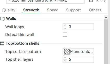

Turn on “Detect Thin Wall”
Capture
I new there was a way ! Thanks for reply, all works okay. Cheers
