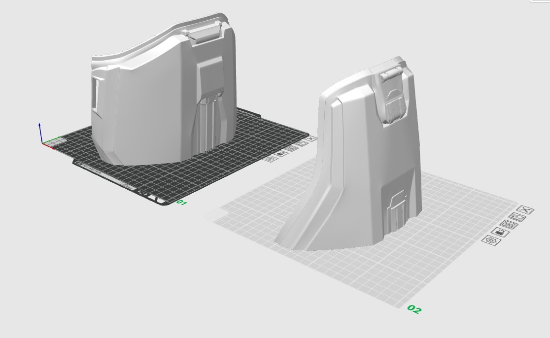

I am printing this file for my brothers armor, the plate 1 successfully printed without any problem.
Then the next day I tried to print the plate 2 in about 50% it failed or experienced problem, it’s still printing but nothing is coming out in the hotend so I stopped and unload the filament (no problem unloading)

Here is the best example I have
(Finished print but the L purged line is incomplete or too thin and the print sample is not printed)
