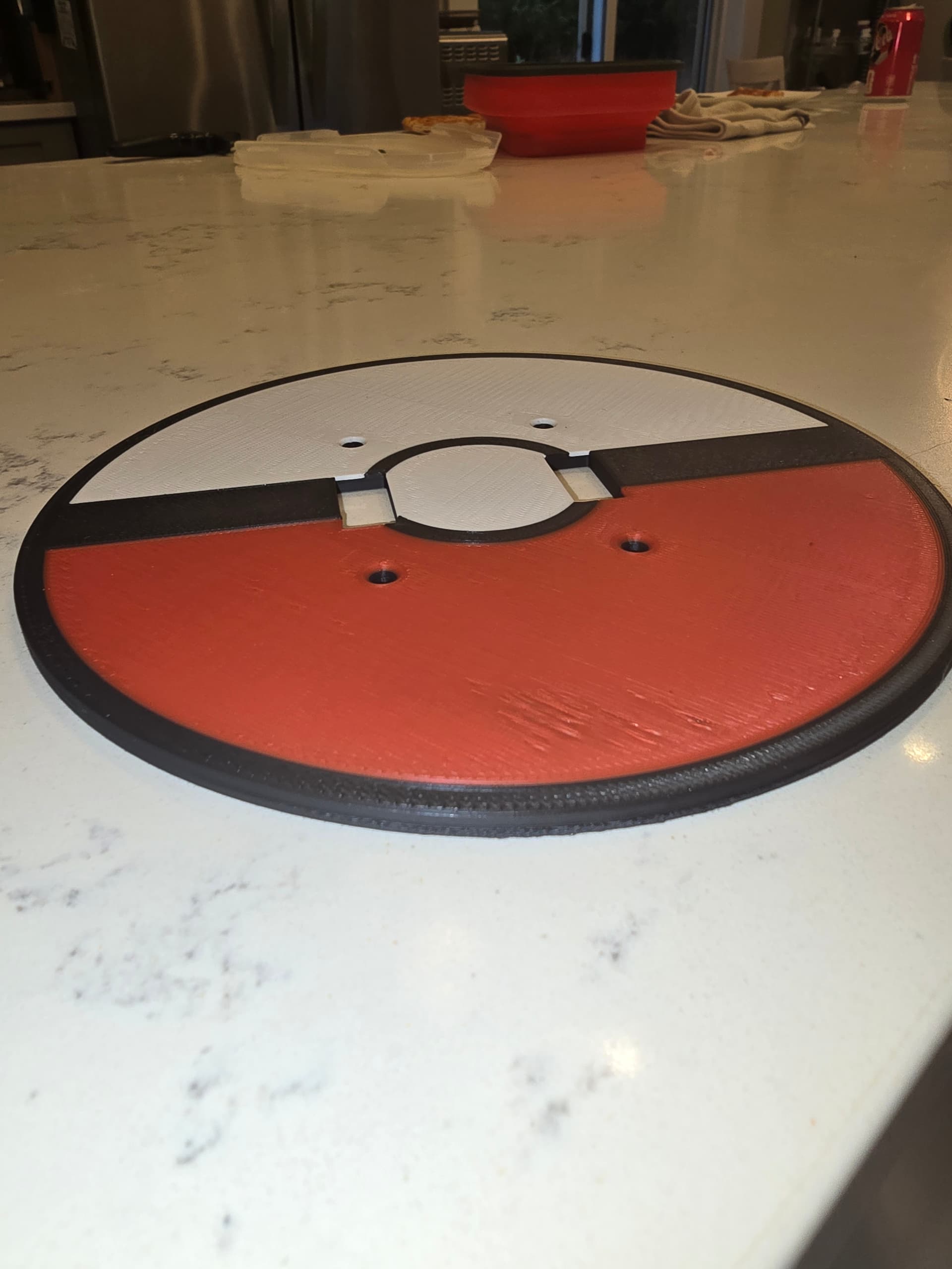

I’ve been printing large projects on my P1S with no problems. Suddenly I’m getting pillowing and other nasty effects on my first layer of another project. Since this is a face-down print, the effect is huge gouges and grooves on the face, which is unacceptable.
I’ve been troubleshooting for two days. I did flow calibrations and the smoothest swatch is zero. But I still changed flow rate up and down and get the same effect.
I’m using the same filaments as I just used on other projects, and they are in a Sunlu filament heater mounted on my AMS. RH < 20%.
I don’t know what to do next. This print is in the same project as the one that prints fine, so they have the same settings. I’m printing first layer at 50 mm/sec. 220C, bed 60C supertack plate.

Holy moly! I just started it again with Z offset of .04 and so far it looks smooth. We’ll see. I’ve never made that change before.

How are you cleaning your plate?
Pillowing like this is often caused by contaminants such as finger oils on the plate.
Hot water and Dawn. Cleaned it right before this print. And all the others.
I have a Pei Plate as it came with my printer.
Do not be afraid to use a brush as shown on the wiki: Bambu Lab Textured PEI Plate Cleaning Guide | Bambu Lab Wiki
For other plates most likely similar.
I continued to troubleshoot with AI. Adding a Z Offset of .04 made it better but still had plowing. Offset of .08 cured the problem and I printed two more with very good first layers.
