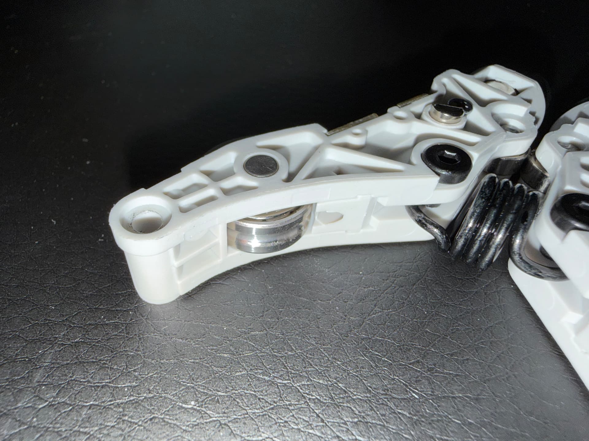

Also, check the idler wheels in the filament path—they can accumulate a thick layer of residue that causes slip as well. In my experience, I had a thick film on mine that caused slipping, plus black buildup around the extruder gears.
It all looked fairly clean, but indeed some fine particles and some string (filament/tape?) around the idler wheels. I had previously already removed some but then I didn’t remove the entire mechanism.
Your extruder gears look quite clean, so that’s good news! However, I’d still recommend giving the idler wheels some extra attention. Even if they look relatively clean, they can accumulate a thin, almost invisible film that reduces grip at higher flow rates.
Also, check along the right side of the mechanism (visible in your first photo)—I had a black greasy residue there that felt like melted filament or grease, and it was affecting performance. Worth making sure everything in that area is completely clean.
That’s exactly the thing I removed from the idler gears! So we’re hopefully on the right track.
And yep, the photo was taken after I removed that black residue, thanks for confirming you had the same issue. Fingers crossed now for when I’m doing the max flow rate test :crossed_fingers:t2:
