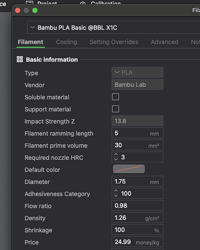

the unit is “money/kg” Everyone has different moneys. If you like tracking this, Assign your value in the filament section. It’s near the temperatures, etc.

That estimae is based on the price set in the filament setting, shown at the bottom of the screenshot below. Edit that to the price you paid for kg and to the currency of your choice to have a more accurate estimate.
