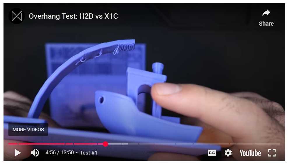

This guy does a very thorough job of comparing H2D and X1C in regards to overhang:
The headline is that his testing (at least his initial testing reported in the youtube) indicated H2D’s doesn’t handle >45 degree overhangs as well as X1C. What he didn’t say, and which I’m hoping is true, is that this is the result of the default print profiles rather than something inherent in the H2D design. Perhaps the current defaults are a bit crude and can be improved enough to close the apparent gap in performance? Anyone know?

He only played with fan speed. He needed to look at overhang speed. I have had similar issues on my X1C, and I adjusted overhang speed and got perfect prints when I got it just right.
It may be that the minimum layer time needs adjusting as well, because the point of failure in that overhang test on at least one of his test models was high up, with pretty much nothing else to print, except for a very small curved pillar, so he may have had that dialed in too fast without enough layer cooling time built-in.

I found the model on makersworld that he used:
and printed it directly from the Bambu Handyh, which means it printed using whatever its default is for PLA, even though I was using Sunlu HS-PLA. Therefore, the print conditions were not tuned to my filament. i.e. my print situation was worse than his.
Nonetheless, although his print started failing the tall arch fairly early, mine did not. The print became thinner at 70 but didn’t start failing on the bottom until it got to 80.

I printed several of a similar test (at least the overhang part,) on mine, and my ABS results are a bit better than his PLA results. My PETG result is a bit better than that and my PLA results are near perfect up to and including 80 degrees. 90 degree overhang is a bit messy on the bottom, but plenty usable.
