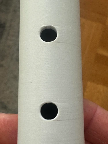

Suggestions on how to correct this?
Whenever I print a tubular shaped object with round holes in it, I get these lines to the right side near the top and bottom of the round hole. I’m using an H2D. Does anyone have any idea what might be causing this and how to eliminate it?
Have you tried turning on polyholes or experimented with the inner/outer/inner option in the “walls printing order” dropdown menu in the “quality” tab?
I don’t see polyholes as an option in Bambu Studio. But yes I have tried switching inner/outer etc with no improvement.

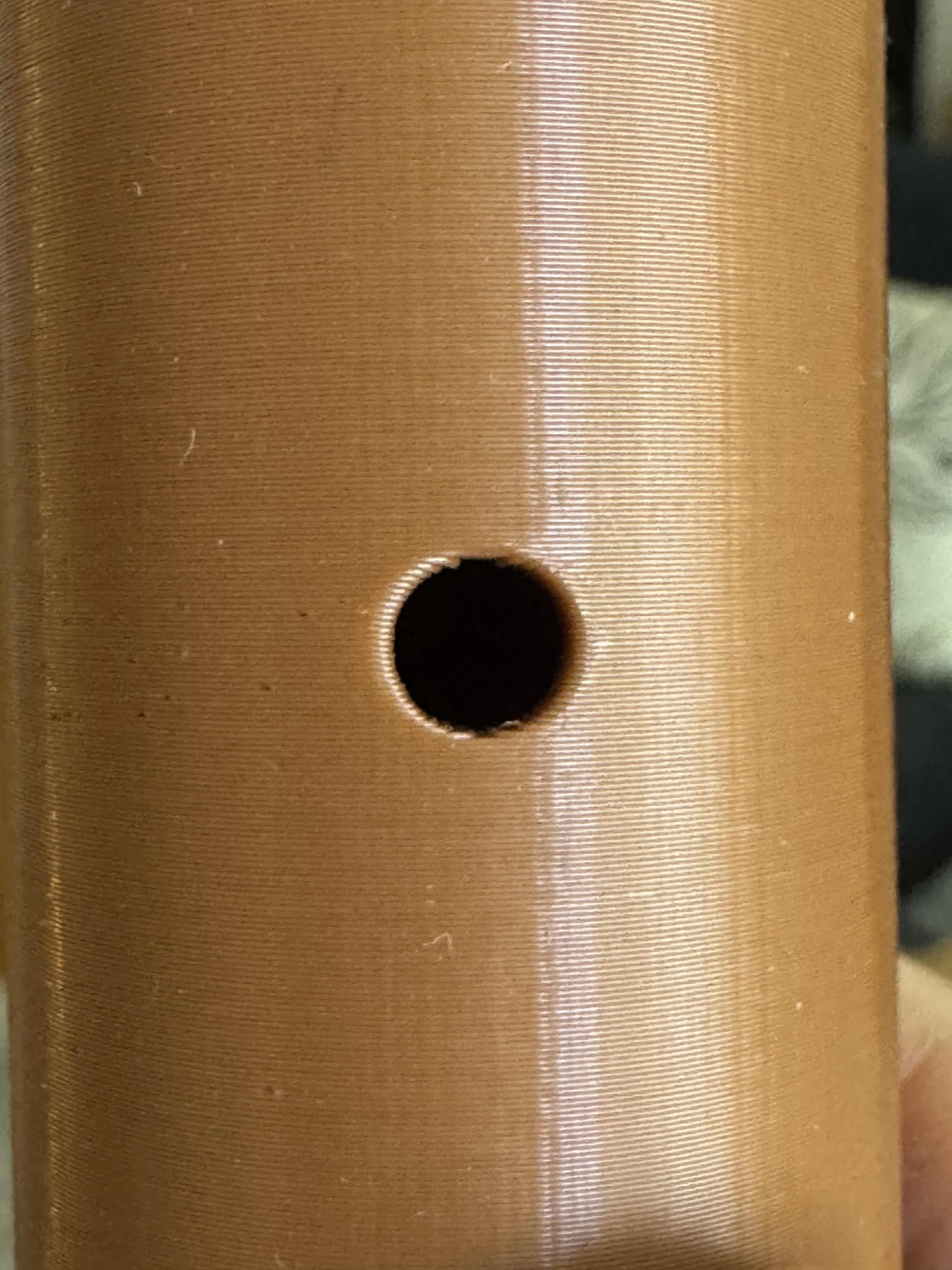

I have tried all the things you mentioned. Slowing the print speed down helps a little, but does not eliminate the problem. I know for a fact these can be eliminated. Here is an example.
However, I don’t know if this was done on a Bambu printer.
Could you post a photo of your new print and compare?
The other print that you showed looks like was printed super slow, and with a very small acceleration value, judged by the corners. Which essentially should be similar to adjusting the smooth coefficient.
