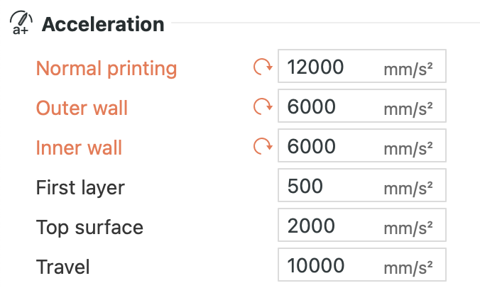

Cranking up the acceleration by 20% reduced the print time even more without any decrease in quality.

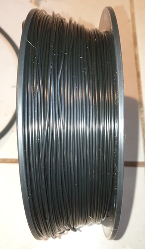

I definitly said goodby to Geeetech filament, their low cost PLA does artifact on prints, cant go over 15mm ³/s and even one (the Silver one) clogged my nozzle each time I tried it. So I wanted to try their HS-PLA but they are really unproffesisonal, in 2023 it is unaccceptable to receive such spool… here is what the last spool (HS-PLA from Geeetech) I received look like :
I had to unroll/reroll part of it beacause it was strangling/knots and also was not rolling into the AMS due to the filament that was larger than the spool as seen in the picture.
I just switched to eSun PLA+ and wow, what a change ! it print fast, it print well (but a bit more pricey)
