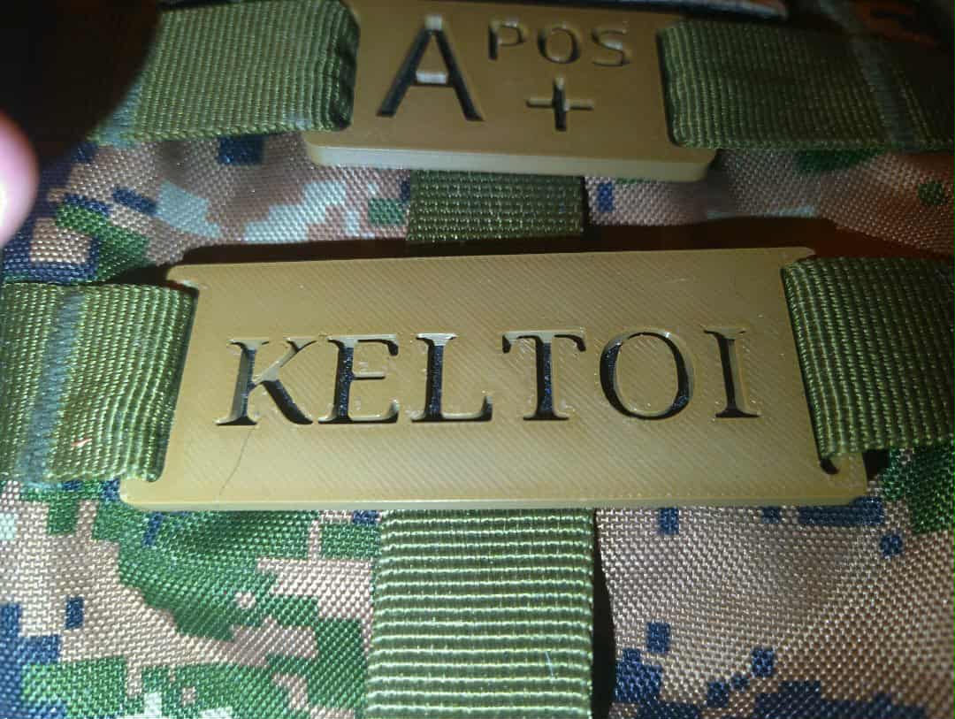

Hi all
I used to be able to create molle name badges with cut out letters and different colours inside each letter.
After creating the text I click “Cut”.
Them select “Paint” , pick a different filament colour, then the paint can icon and click on each letter
I can’t do that anymore, unless someone has a workaround for me
Please help

In one of the newer updates they made it so “Edge Detection” was unchecked by default. Turn it back on and see if that does it.
Ah mate, it didn’t make any difference.

I don’t know if this is relevant for your problem, but this is how I in BambuLab studio color letters. I have attached a 3mf file with a simple example.
Make a simple cube and place a text on it as cut type.
Select both the cube and text,
Go to Mesh Boolean and subtract the text from the cube.
Go to Color Painting and fill the letters with the option Edge detection on.
CubeWithText.3mf (69.2 KB)

Found a workaround but not happy with it.
Create the tag, and letters. Click “Cut Out”.
Drag the letters seperate. Copy letters to seperat plate.
Print tag.
Back to letters, flip them so they rest on their faces instead of floating in mid air.
Print in font colour required.
Tap them into the holes on the tag.
