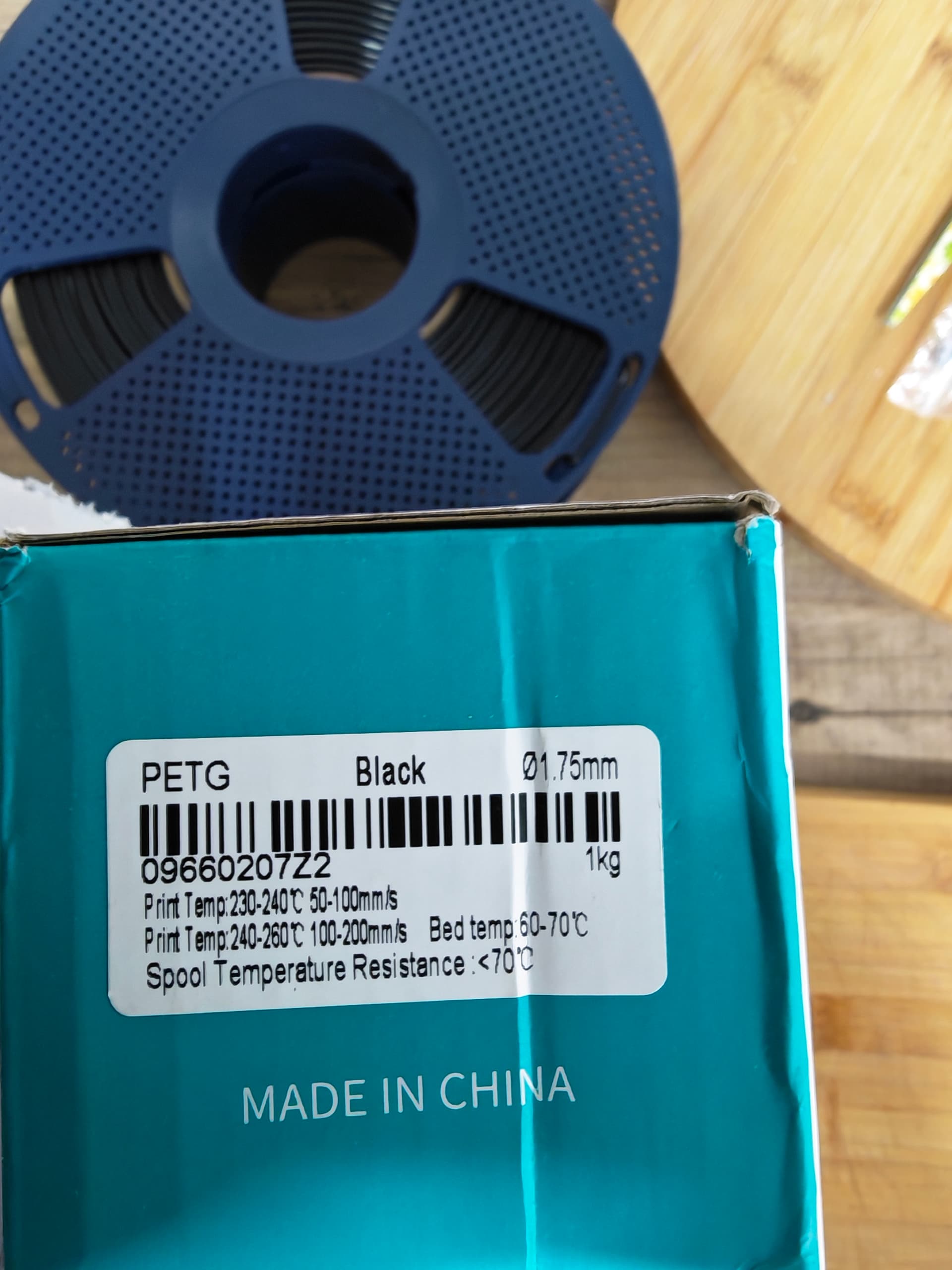

Hi, I just got some Sunlu PETG Fiber from Temu. But on the box I Can not see it saying ‘Fibre’ anywhere on the 9 boxes I got. Just PETG, which I ordered on 9th March just got here today.
Now it looks like normal PETG; it’s shiny. I have ordered about 30 kg of Eryone CF from Temu, and Eryone is matte-looking and a bit rough to touch, not much, but completely different from what Sunlu Fibre has sent me. I did check I ordered it right, and I did lol.
Plus, look at the quality of packaging with just a plastic wrap. Now I do get on to temu and get some money back. Because most of the companies send it this way.
So has anyone else had Sunlu PETG fibre, or have I been sent the wrong filament?
Fiber filaments almost always have a rough exterior. You got regular PETG, or as we say here, you got wish.com fiber filled PETG
That is what I thought, Mate. I will have to get on to Temu to get a refund or partial refund.

IMO you got shipped the wrong filament

Yes, you got sent the wrong filament. I do own the Sunlu PLA-CF though.
Did it say PETG Fiber or PETG-CF? Like was it carbon fiber or was it mentioning that PETG is a polymer🤣
It just said ‘PETG’ and nothing else but what colour it was.
But the Eryone says PETG-CF is on, and it’s not shiny like the Sunlu PETG.
