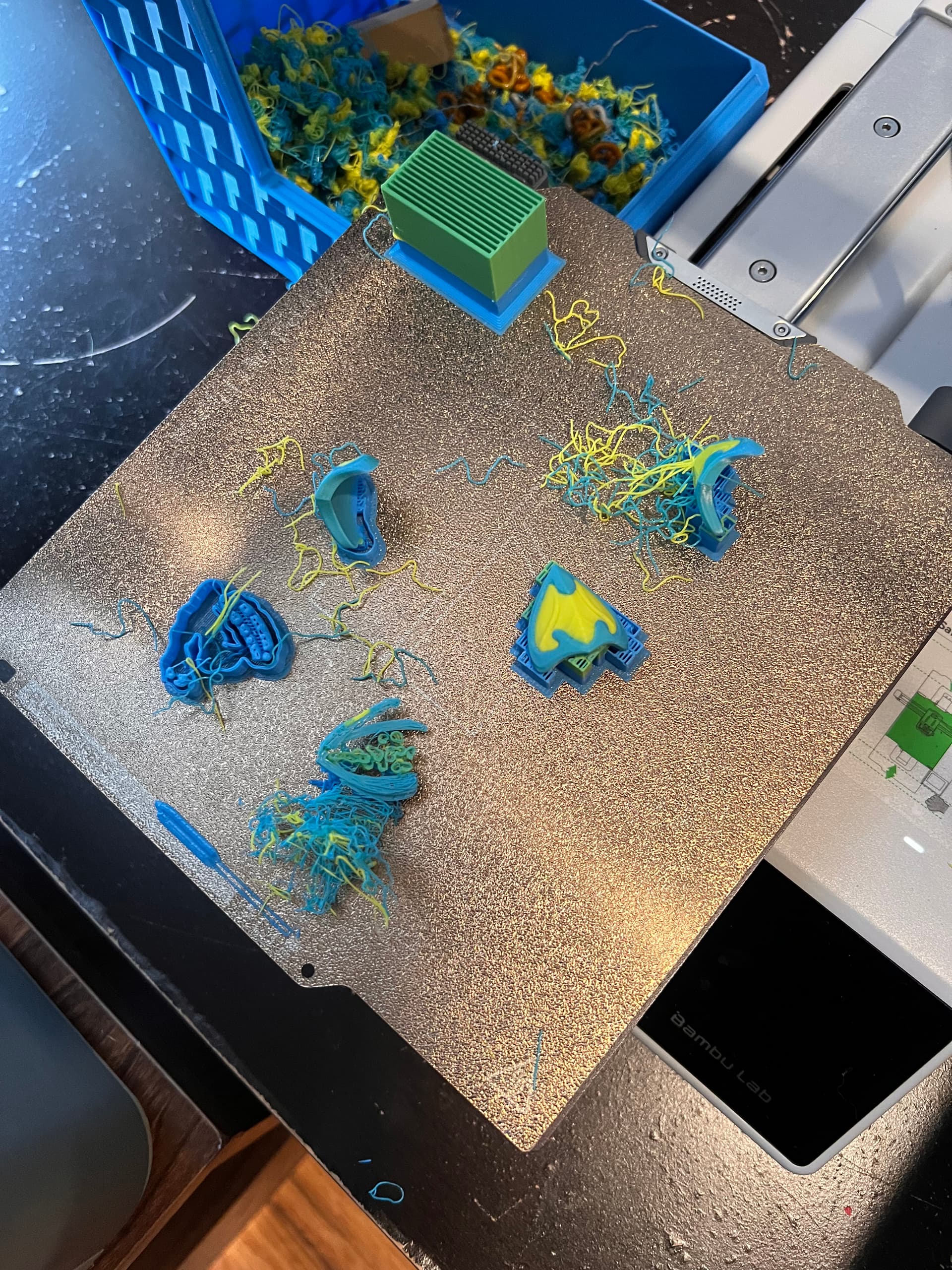

In one of my recent use cases, normal support is the clear winner. This is the post print model, where I compare tree vs normal on 2 different orientations. All other settings equal, only changed object level support type from Tree (Auto) to Normal (Auto)
The vertical normal one looks bad, but it for the purpose of the test, it is a successful one because it’s still standing. The horizontal tree one gets completely knocked off and spaghetti entails. The other 2 look good here, but in another print, vertical tree gets knocked off at about 90%. Only horizontal normal is consistently successful. The supposed advantages of tree over normal are also not present in this use case: post removal surfaces look similarly rough, trees break off leaving tiny remnants on the object that require a deeper removal.

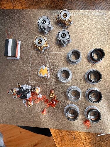

In another use case, normal is also the clear winner. This is a big print as there are a lot of filament changes (4 color), many flush objects, totaling 50+ hours. This is the plate using tree support, which I have to cut losses and stop at about 25% because the trees on my main objects have broken and will no doubt end in spaghetti.

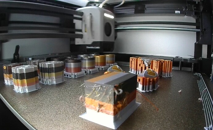

And this is the same print using normal support which is currently printing great and at roughly the same % of progress
As you can see, no broken support problem. The broken trees in the first photo, again, are also hard to remove, leaving tiny pieces behind, with surface not looking smooth either.
Everything else equals, only support type diff. Also no bed adhesion problem, as the tree roots are still there. At this point I do not see a reason to use trees, as I do not see any theoretical advantages of trees over normal.
