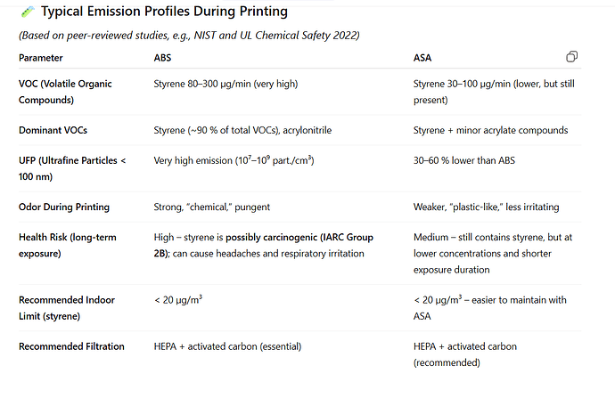

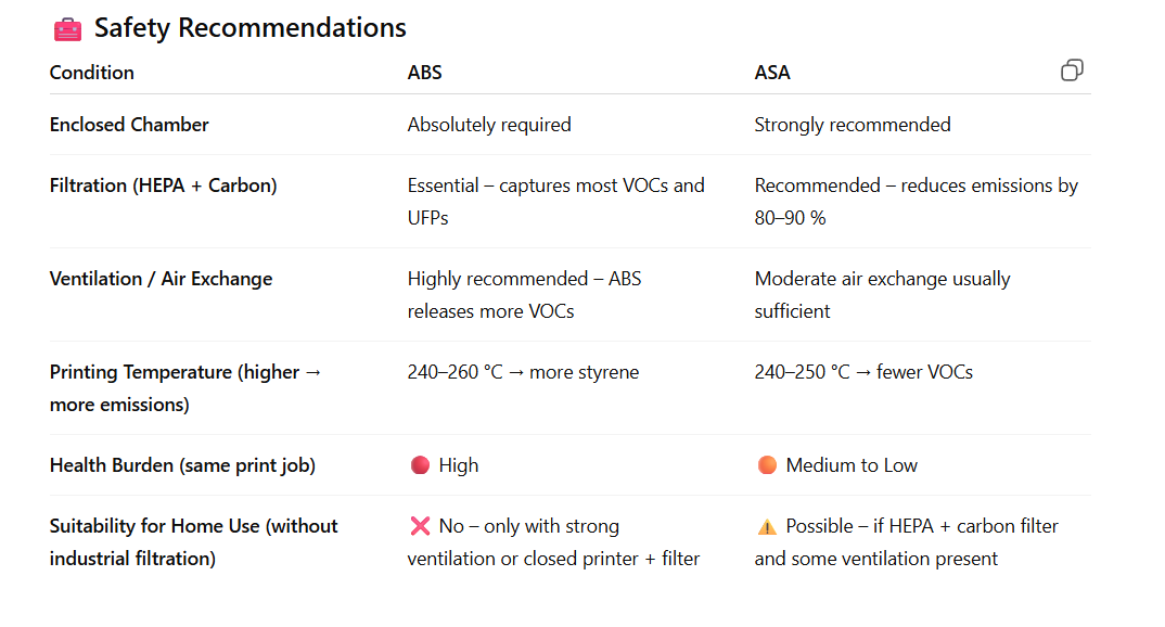

The problem I have with ABS isn’t primarily the smell you can smell it, yes but the particles that can only be captured with activated carbon. Just to make sure I wasn’t talking nonsense, I asked GPT about it, and it provided a really good article along with some sources, which I’ve included below.
I printed with ABS only once back when I had the MK3S+, and the experience was terrible. Now, when I use high-quality ASA, I don’t smell anything, and there’s a much better chance that the filters in my printer can actually capture the emissions. That’s why I use ASA.

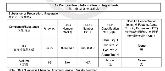

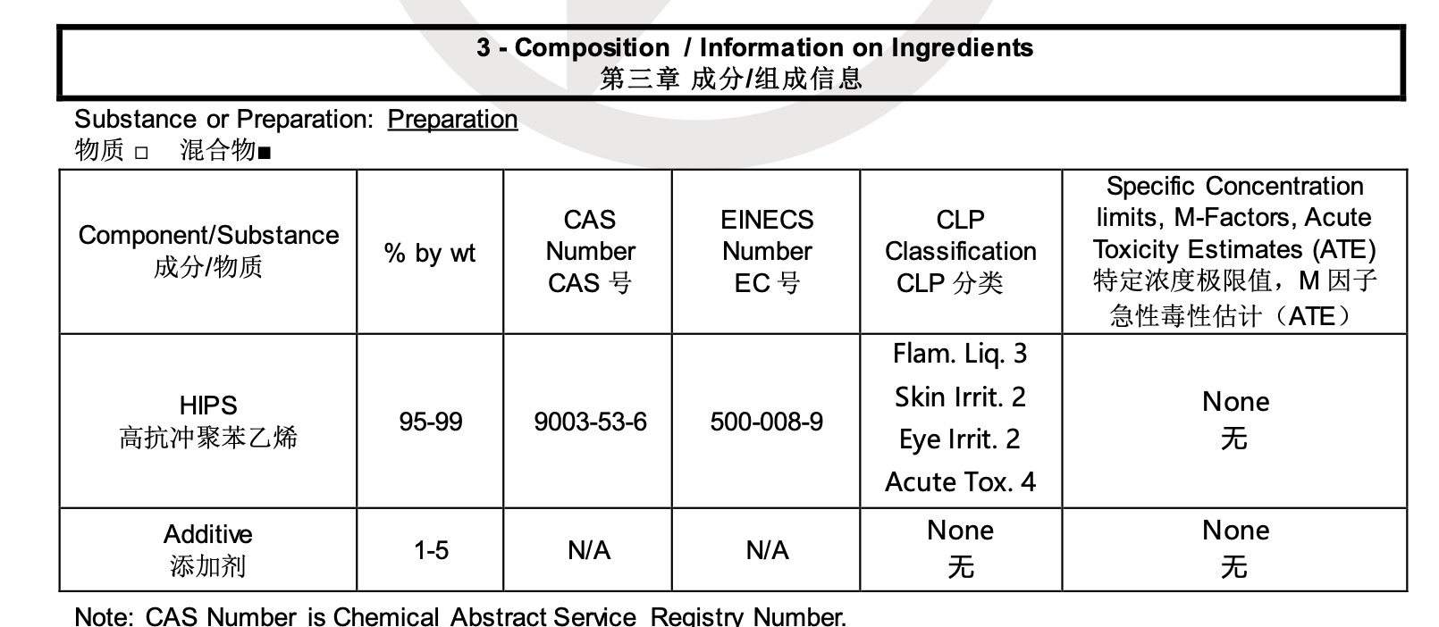

Support for ABS is HIPS plus some additives, from the TDS/MSDS:

ASA is generally superior to ABS for outdoor use due to its excellent UV resistance and weather durability. While ABS tends to fade, crack, or become brittle under sunlight, ASA retains its color, strength, and surface finish even after long-term exposure.
If you’re concerned about airborne particles, you should be aware that all filament types emit them to some extent. Even PLA releases ultrafine particles and volatile compounds, which can be harmful at certain concentrations or with prolonged exposure.
In general, PLA emits the least. PETG is typically higher than PLA but still below ABS in most studies. ABS and ASA produce the highest levels of ultrafine particles and VOCs, especially at higher nozzle temperatures.
I have a particle meter positioned right outside my printer’s exhaust, and the readings never exceed normal background levels. The fact that you can smell something doesn’t necessarily mean it’s harmful — our sense of smell is simply sensitive enough to detect even trace amounts of certain compounds.

The main issue with ABS/ASA isn’t the particles. It’s the VOCs. In particular styrene, which is considered “probably carcinogenic in humans”. The other stuff in the fumes also isn’t healthy.
So in this case: if you can smell it, it does harm you.

Also, keep in mind that activated carbon saturates very quickly and loses efficiency rapidly at elevated temperatures. The built-in filter is therefore far less effective than many people believe.
That’s a good point. The chamber temp of the H2 is already high enough that activated carbon looses most of its effectiveness.
